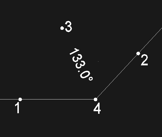

rkent
With the dim extension lines and dim lines suppressed, use the macro
^C^Cdimangular;\\a;\\\
This will require you guessing at the angle but it will be close and probably look alright. See attached. Once you have the macro assigned to a toolbutton, pick it to start, pick in the order and location shown.
Very quick and dirty, someone in the lisp area can probably put one together to do exactly what you want with two or three picks.

BIGAL
You only need pick 2 pts the only trick is that you pick each line near the angle intersect as you can then work out the line direction correctly you need a yes/no greater than 180 I use enter or any key, so it puts text correct side. Very fast way to do, only hiccup is I have to find time to put it together, will try.
Just had a quick play and the easiest way is to just do DIM ANG then using vl get the properties
ExtLine1StartPoint = (413.816 193.671 0.0)
Measurement (RO) = 2.18021
TextPosition = (395.766 231.118 0.0)
This is all you need the extline1.. is the intersection pt and the Textposition is the centre of the text so gives position and brg of text Measurement is answer in Radians just entlast and delete last.
