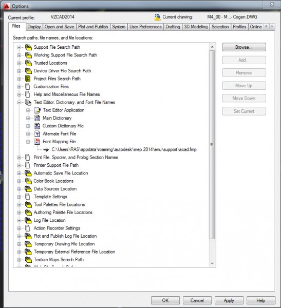

RobDraw
The first tab in options:
Share this post
Link to post
jsdrftng
ahh, yea mine has the fonts i'm using in the folder it's mapped to
