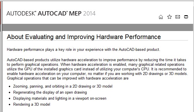

RobDraw Posted February 6, 2015 Posted February 6, 2015 It sounds like you've got some major performance issues, willb. Your experience is not typical. An inadequate video card can and will have an effect on AC's performance. A better one will improve it. It is not an end all, be all and may not be in the case for the OP but saying it has little to no affect is not accurate. If what you are saying is true then AutoCAD help is lying. Quote
SLW210 Posted February 6, 2015 Posted February 6, 2015 OP->Always be careful of the repeated claims that buying a video card for AutoCAD is going to be of any benefit. I've done much testing on this subject and I can confidently say that the video card plays an almost zero role in improving AutoCAD performance. I'm speaking specifically about AutoCAD 2015 and 2014 which uses DirectX/Direct3D video cards. AutoCAD prior to 2008 (?) supposedly had OpenGL code and at that time workstation cards such as Quadro/Firepro were used. Since i'm fresh to this game (AutoCAD) I can't confirm any performance characteristics of those systems. However, monitoring GPU usage with Nvidia Inspector clearly shows the video card isn't utilised. I use a modified X-Ray visual style with materials, textures, shadows off with a Faceted lighting quality (far too difficult to use Wireframe as there's just too many line obstructions for me-3D only). Monitoring the CPU however will show a single core fully utilised with a 100% load proving that AutoCAD is purely a single threaded CPU bound application. I can also verify that AutoCAD 2015 is very slow and laggy in the many ways you've mentioned. The GUI is noticeably slower than that of 2014 as they've changed all the GUI typography and created that dark them which slows things down considerably if one was to compare both versions side by side. However, 2015 dramatically improved multiple object selection for me. In 2014 it was almost impossible to select many objects to perform routine commands, mirror, rotate, copy, move etc, AutoCAD with cough, splutter and take over 30 seconds to select then over 1 minute to begin the task and then freeze up, hang in any visual style aside from 2D Wireframe. AutoDesk unfortunately appears to have a 'deny all' and 'don't give a ****' type attitude and have no aspirations of improving the performance of their product, well the only performance they seem to care about is sales performance. What was the exact response Autodesk gave you when you contacted them? Quote

willb Posted April 17, 2015 Posted April 17, 2015 Forgot about this. The Autodesk reps are just a bunch of sales 'mooks' and are mostly clueless, they're only interested in selling more licenses. When it comes to Autodesk support, they either do not bother to respond or you'll get a scripted company line such as 'we've never heard of any problems from other people, you're the first case and as such it of little interest to use to investigate further, good bye thanks for lining our pockets'. ->RobDraw I don't know anything about MEP AutoCAD, but if they say that about AutoCAD than I can positively say it's absolutely false. Look the only time I see the GPU being hit is when Selection Preview Highlight is enabled and the cursor runs over an object, the GPU will spike a bit maybe 30%. Also a spike when those hove over tags pop up. This is useless because when performing normal use tasks such as a full orbit, rotate, pan etc the GPU is practically idle. This is still the case in 2016. Also in 2016 they have reduced the time it takes to select items, but only in 2DWireframe, none of the other visual styles have any improvement, also a little more responsive to copy the selected items, again only 2DWireframe. For 3D anything other than the most simplistic small models it's not really practical to work in 2DWireframe, there's just far to many lines and it's incredibly difficult to retain a sense of location. Ideally i'd spend 99% of the time in X-Ray, and the other in Realistic to detect any obstructions. As it is, there'd need to be a minimum of a 12GHZ CPU to adequately push the models around. Since that isn't happening anytime soon a pair of Geforce video cards could handle it right now if the 3D pipeline was coded to utilise them. Quote
