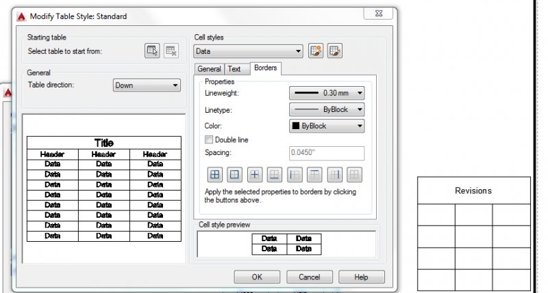

iloilmarketing Posted February 26, 2015 Posted February 26, 2015 I am trying to create a table to use as a Revisions Box for my current drawing and future use. I have the table created with the rows and columns as I would like them. My issue is I want to match the line thickness of my title block for the table. For the life of me I have tried everything to change the thickness of the lines with no luck. Can someone shed some light on this for me? Quote
Dana W Posted February 26, 2015 Posted February 26, 2015 What is everything? Have you tried the table style editor? Have you put the table on the same layer as the lineweight you want to use? Have you assigned the borders to the lineweight property of "By Layer" in the table editor? If you are not using layer controlled lineweights and colors, have you set these properties to the lineweight and color in the table style editor? Quote
iloilmarketing Posted February 26, 2015 Author Posted February 26, 2015 Yes, I tried to use the table style editor to change the line weights with no luck. I tried to go to the layer properties of that layer and change the line weight as well with no luck. Here is a snip of my standard table set up in the table style editor: Quote

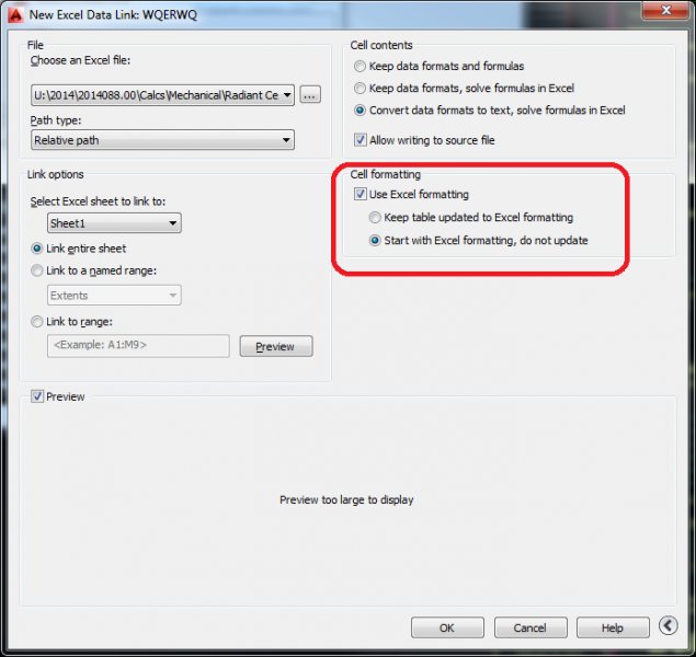

RobDraw Posted February 27, 2015 Posted February 27, 2015 It sounds like you may be using the Excel formatting. When you create a table, you have to choose to format it AutoCAD or use Excel formatting. I'm not sure if it works for line thickness. I've never tried it but it sounds like it might with seeing what you are experiencing. Try changing the lineweights in Excel and reload. Quote
Dana W Posted February 27, 2015 Posted February 27, 2015 Hadn't thought of that, here. Could be it, alright. Quote
RobDraw Posted February 27, 2015 Posted February 27, 2015 I couldn't find a way to change it after inserting, though. Quote
iloilmarketing Posted February 27, 2015 Author Posted February 27, 2015 I just used the table command, I don't see the option for AutoCad or Excel. Is there any way to change the lines with how I have it now? I uploaded the drawing in my last post. I can recreate a new table if needed however I can get the lines to look bold works for me. Quote
RobDraw Posted February 27, 2015 Posted February 27, 2015 When you insert the table and get to the dialog box I am showing, there is a small round button with a ">" symbol. Click that to expand the box to see the options. Have you tried changing the line thicknesses (or color) in the Excel file like I suggested? Quote
iloilmarketing Posted February 27, 2015 Author Posted February 27, 2015 To clarify, I am not inserting anything. I am simply using the table command and creating a brand new table within Autocad. After creating the table I use the command tablestyle to go into the editor. Click on standard > modify (I chose to use a standard table when creating). I can change the settings within the general and text tabs, but anything I change on the borders tab just goes back right after I click ok and go back into table style editor. Quote

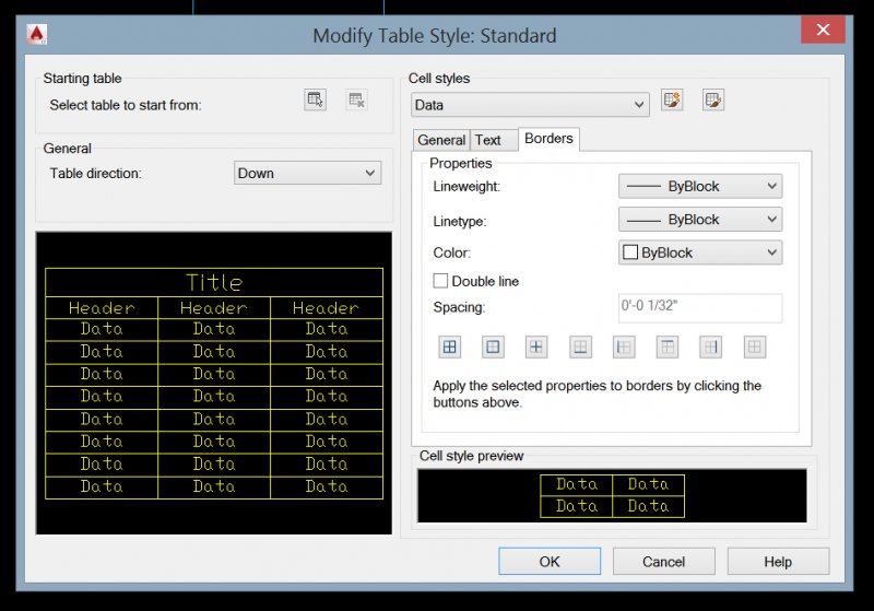

RobDraw Posted February 27, 2015 Posted February 27, 2015 Okay, I see what's going on, now. See image in post #3 above. After selecting the correct properties, you have to apply them with buttons underneath the selections. You can apply your selection in a variety of ways. I hope that is enough of an explanation. Quote

Dana W Posted February 27, 2015 Posted February 27, 2015 Okay, I see what's going on, now. See image in post #3 above. After selecting the correct properties, you have to apply them with buttons underneath the selections. You can apply your selection in a variety of ways. I hope that is enough of an explanation. And this was the other half of the solution. Quote
