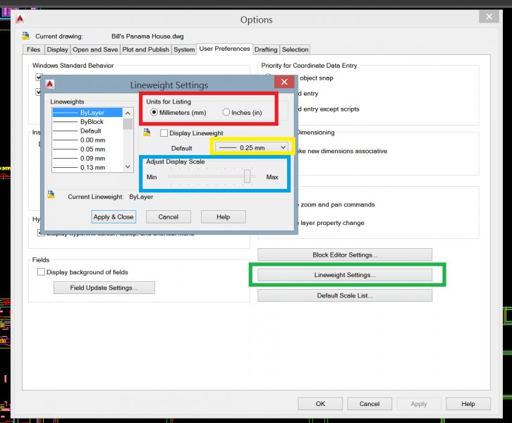

Ok, let's get even more basic than Rob and Big (Reality TV reference). refer to the attached image that I have drawn rectangles on.
In Options > User Preferences tab, there is the Lineweight Settings button (Green). Click that. You can also get there by simply typing LWEIGHT , by clicking the down arrow next to the LWDISPLAY toggle button on the task bar.
Then select Units For Listing(Red). This setting is up to you, or your office standards. It has no relation whatsoever to your drawing units or insert units. Its control over lineweights is absolute, and exclusive. You can use either listing unit in both metric and Imperial drawings. I personally use millimeters even though I draw in Imperial units because the increments are in a logical set of numbers. I simply don't think in thousandths of an inch.
The Yellow rectangle shows where you can change the default lineweight if what you have for yours doesn't suit you.
Above the yellow rectangle there is a checkbox, but it also gets switched by the task bar button so ignore it. They both change the value of the same workspace setting variable, LWDISPLAY or . By the way, with LWDISPLAY ALL lines in modelspace and paperspace, except for the plot preview are displayed only one pixel wide. The hard copy still prints in true line width.
In the blue rectangle there is a slide button. It controls how much differentiation between lineweights is displayed in modelspace. Modelspace lineweight display is not reality. All that shows you is that some lines are fatter than others, in a relative sense only. The lineweight display in modelspace does not respond to zooming. The apparent thickness always stays the same number of pixels.
In paperspace, with Lineweight display on, lineweights are displayed at their actual width down to the mechanical limits of the display screen. In other words, no line thinner than a pixel width can have its true width displayed. Lineweights do respond while zooming in paperspace, so you may not be able to see any differentiation unless you zoom in far enough for them to be wider than one pixel.
In the plot preview, lineweights will display at the thickness they will be plotted, just like in paperspace and the differential will not be visible if zoomed out far enough because again, a pixel width is the bottom line.
On the paper, lineweights result in exactly the line width you specify. Well, at least down to about 0.002 mm or so. An ink droplet is only so small.
