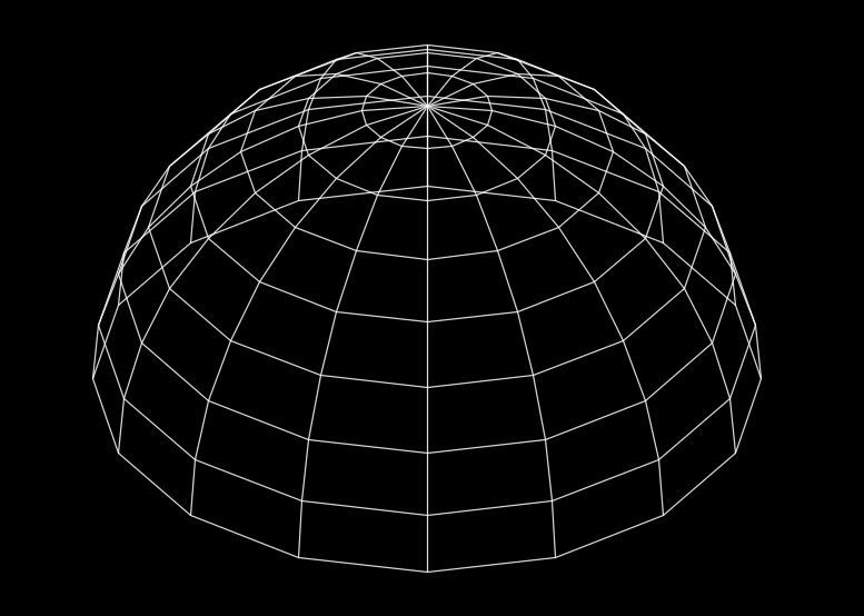

ReMark Posted March 11, 2015 Posted March 11, 2015 I just found it on the Release 14 CD. Loaded and tested. It works. The command is AI_DOME. Command: AI_DOME Center of dome: Diameter/: 60 Number of longitudinal segments : Number of latitudinal segments : I accepted the defaults as shown. Now about that beer and steak you offered earlier.......... Quote
ReMark Posted March 11, 2015 Posted March 11, 2015 I guess I could just attach a copy of the lisp routine to a post, right? Quote
ROBP Posted March 11, 2015 Author Posted March 11, 2015 I just found it on the Release 14 CD. Loaded and tested. It works. The command is AI_DOME. Command: AI_DOME Center of dome: Diameter/: 60 Number of longitudinal segments : Number of latitudinal segments : I accepted the defaults as shown. [ATTACH=CONFIG]53207[/ATTACH] Now about that beer and steak you offered earlier.......... Voila for now since Del Frisco's is 8 hours away in Boston they also have one In Charlotte to just saw it Quote
ROBP Posted March 11, 2015 Author Posted March 11, 2015 [ATTACH=CONFIG]53208[/ATTACH]I guess I could just attach a copy of the lisp routine to a post, right? Would be great to have indeed since disclaimer permits Thanks R Quote
