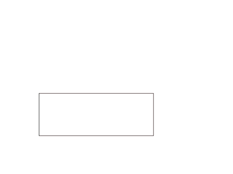

nestly
Following along with SLW's comments, does this illustrate the problem? .... a solution?
