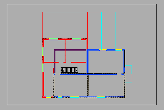

neilg81 Posted March 22, 2015 Posted March 22, 2015 (edited) Hi people I'm very new to Autocad been using it at work to read drawings so I thought I would draw my own plans for my extension. So far so good till I get to printing them out to scale!. I set the paper size then when i try choose the scale it alls goes crazy!. I've read loads and watched loads videos about how to print to scale but I'm still getting no luck! Scale does not work correct!. Ive attached my drawings. Please help Thanks Neil Heath10.dwg Edited March 22, 2015 by neilg81 File attached Quote
Cad64 Posted March 22, 2015 Posted March 22, 2015 (edited) Ok, first off, welcome to the forum. Now for the bad news. It seems you have committed a cardinal sin in the world of CAD. You've drawn your floorplan at a scale instead of drawing full size 1:1. You should ALWAYS draw full size in Autocad. This is why your plot scale does not work correctly. Your drawing is already scaled. Your Units are set to millimeter but they should have been set to meter. I'm not sure what to tell you except to scale your drawing up in model space so that it is at actual size. Then you will be able to set your plot scale correctly in paper space for printing. Edited March 22, 2015 by Cad64 Quote

gazza_au Posted March 23, 2015 Posted March 23, 2015 Drawing2.dwg there you go, iv'e added an A1 template, model space now in Meters. I also added a dynamic scale bar in paper space. you view is now 1:100 Quote
Dana W Posted March 23, 2015 Posted March 23, 2015 Well that would be very nice, but you have only set the insertion units to meters, not the drawing units, which have now been set to millimeters. Modelspace is now in millimeters, not meters. Neilg81 is a self admitted noob, who still does not know how to get their own chestnuts out of the fire. The drawing you posted is in this instance a bit counterproductive. One needs to learn to use the world wide convention and draw in modelspace at full size (1:1). The drawing2.dwg floor plan is 1000 times smaller than neilg81's apparently intended meters, at 15.25mm along the "Y" axis. The paperspace layout is 1:100 which means 1 paperspace millimeter equals 100 modelspace millimeters. For a drawing in meters, the paperspace scale will have to have the large number on the left of the colon, or how many millimeters equals one meter. Quote

BIGAL Posted March 23, 2015 Posted March 23, 2015 Like Gazza Architectural in Australia is drawn in mm so I would rescale x 1000, Then in layout draw a box reflecting the size of your sheet for A3 thats 420x297 then do a Mview inside and set your scale, you are very close to something that is simply workable. Quote

Dana W Posted March 23, 2015 Posted March 23, 2015 (edited) Hi people I'm very new to Autocad been using it at work to read drawings so I thought I would draw my own plans for my extension. So far so good till I get to printing them out to scale!. I set the paper size then when i try choose the scale it alls goes crazy!. I've read loads and watched loads videos about how to print to scale but I'm still getting no luck! Scale does not work correct!. Ive attached my drawings. Please help Thanks Neil OK, I figured out what I did the first try to fix it. When I ran -DWGUNITS, I forgot to tell it to NOT scale the existing objects. They are already only 15 inches tall, we want them to stay the same number of UNITS so we answer NO to that prompt. Conceptually, the drawing will grow to fit into meters. I have attached a FIX. It also has a couple of layouts set up. An A0 in paperspace millimeters, at 10:1 scale, 10mm = 1 meter. an 8 1/2" x 11" in paperspace millimeters at 10:1 scale, 10mm = 1 meter and an 8 1/2" x 11" in paperspace inches at 1:16, 1" = 16 meters just to show how much fun viewport scales are. At this point I'd suggest again to look into why you want to draw in meters. A good deal of the parts of a house are an extremely small fraction of a meter. How I fixed it: First, I turned on the OFF layers, and erased the giant stair. Then I ran the command -DWGUNITS, and followed the prompts (the second time, correctly:oops:). Here is a list of the command's prompts, and responses. Command: -DWGUNITS Loading AEC Base... Loading AEC Base Extended... Loading AEC Core... Drawing units: 1. Inches 2. Feet 3. Millimeters 4. Centimeters 5. Decimeters 6. Meters Unit for length 6 Drawing unit display formats: 1. Scientific 2. Decimal Linear display format : 2 Linear display precision : 2 Scale objects from other drawings upon insert? [Yes/No] : YES Match INSUNITS to drawing units? [Yes/No] : Yes ** WARNING: you have changed the unit for this drawing database. ** ** All new objects will be drawn according to the new unit, but ** ** existing objects will not change size unless you specifically ** ** ask to have automatic scaling occur. ** Scale objects in current drawing to reflect change in units? [Yes/No] : NO (This is where I answered YES incorrectly, for the second time in about a week. See, I don't use this command much at all, I draw in the correct units in the first place.) Command: Heath10 units changed.dwg Edited March 23, 2015 by Dana W Quote

eldon Posted March 23, 2015 Posted March 23, 2015 Some of the previous replies were quite curious. When I opened the drawing, the dimensions matched the lengths being dimensioned. So the drawing was drawn in drawing units that were meant to represent one metre. However, the drawing was started on an Imperial template, which means that when you are trying to scale for plotting, you have to cope with the metric conversion factor (25.4 or reciprocal) and the fact that there are 1000 millimetres in a metre. AutoCAD plots in millimetres, and there are all sorts of buttons to push, so that you can automagically convert anything into everything. Incidentally, I had heard that the USA was considering changing to the metric system, but they were doing it inch by inch. But to plotting. What size paper were you going to plot on and to what scale? If you choose, say, an A4 at 1 to 100, you have to remember that your plotting units are millimetres and your drawing units are metres. So the AutoCAD requirement is drawing units in millimetres divided by scale. In this case would be 1000 / 100. You can enter it like that in the custom scale, and you should end up with something like this. Quote
steven-g Posted March 23, 2015 Posted March 23, 2015 (edited) Dana By the way congratulations on the new job, I hope your first day goes well, Can I offer a counter argument to your description, it's well written and well thought out but totally wrong the results are good but the logic is flawed. The OP's drawing needs to be scaled at 1:100 that's how metric scale rules are made. The biggest problem always appears to be, not the scale but the misconception of the language, Autocad only knows 2 units, inches and millimeters. When you open a new drawing and draw a line 10 units long, then goto the first layout and highlight the viewport and use the scale drop down and select 1:1, if you have done nothing else, then when you print the drawing, you will have a piece of paper with a line on it either 10" or 10mm depending on wether you have acad.dwt or acadiso.dwt as your standard template. Go to print anything and in the print dialogue box the scale option will allow you to pick 1 mm= however many drawing units, or 1 inch= however many drawing units. You can use any settings you want in -dwgunits, paperspace remains as millimeters or inches. It is common practise in Europe at least to measure and draw in either millimeters, meters, centimeters and even decimeters, so our 10mm long line can be written down and drawn as 10, 0.01, 1 or 0.1 those are full units and it is recomended that you always draw in full units, but three of those are drawn to scale. Full units, full size, full scale and 1:1 are not the same, but all to often that is how they are used in a sentence. The standard scale list in Autocad is setup to work with a unit in model space being either 1 mm or 1 inch, if you change the units in a drawing then 1:1 in paper space will still use 1 mm (or 1 inch) = 1 drawing unit. As Dana pointed out the OP has used an imperial template and then used his site measurement of meters to draw in model space. I don't know if anyone spotted it but the OP did alter the first layout to use A3 paper but incorrectly applied a scale of 1:10 to the paper in the page setup manager. For an A3 size of paper the correct scale to use for this drawing is 1:100. 1 unit on the paper is the equivalent of 100 units on the ground. And it doesn't make a difference what you use to measure with. All the OP needs to do in order to print correctly is alter the scale list. So altering the 1:100 scale to show 1 paper unit equals .1 drawing units or 10 paper units = 1 drawing unit is the correct method, the scale isn't 1/10 it is 1mm = 100mm and 100mm is written 0.1 thats not 1:10 (In my opinion - but I suppose that is open to discussion). To highlight the issue I also included a detail at 1:1 in the layout, and to do that when using meters as your survey units the scale has to be set as 1 paper unit = .001 drawing units (or even 1000 paper units = 1 drawing unit - still open to variations and discussion). Heath10.dwg Edited March 23, 2015 by steven-g Quote
