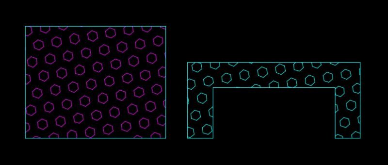

How to hatch so that the hex patten is at the same location as the attached drawings?
Match properties also does not help

vernonlee
[ATTACH]53430[/ATTACH]
Is this what you mean?
No. Basically i can hatch with same patten but as you can see their position is not the same when you hatch it. I need it to be the same.

RobDraw
Before opening the drawing, I thought for sure it was a matter of adjusting the base point but there is something weird happening when I play with it.
Copying one of the hatches gives the desired result.

RobDraw
By default AutoCAD uses (0,0), as the base point for starting a hatch. The patterns are lined up with each other. Think of it as one big hatch pattern but you are only seeing bits and pieces of it. Adjusting the position of the pattern is done by changing the origin of the pattern and can be difficult to achieve what you are saying.
That being said, when I did that with your file I got the unexpected result of the pattern looking like it changed scales but the value did not change.
An alternative would be move the pattern to be where you want it and then adjust the boundary to match the shape.

ReMark
It was a compliment.
vernon: Is this what you are trying to achieve?
As it turns out the hatch pattern on the right is not an exact match. While your hatch pattern angle is called out as being 102 it is really 99.4316.

ReMark
The hatch pattern on the left, in magenta, matches the angle and scale of your original.

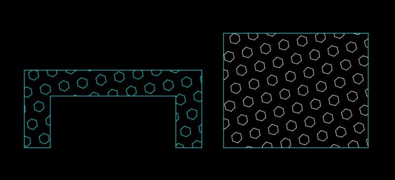

vernonlee
Hi Remark,
Yes. Just that the patten is not align if you alight the top right hand edge. It looks close though

ReMark
Looking close is not the same as exact. Did you see my second attempt?

vernonlee
Firstly, great, but how did you find out the exact scale & angle? I hatch by inhert properties & also by measuring the angle of the HEX patten after exploding it, i still cannot get it to match.
2ndly, is it possible to find out the exact origin point?
