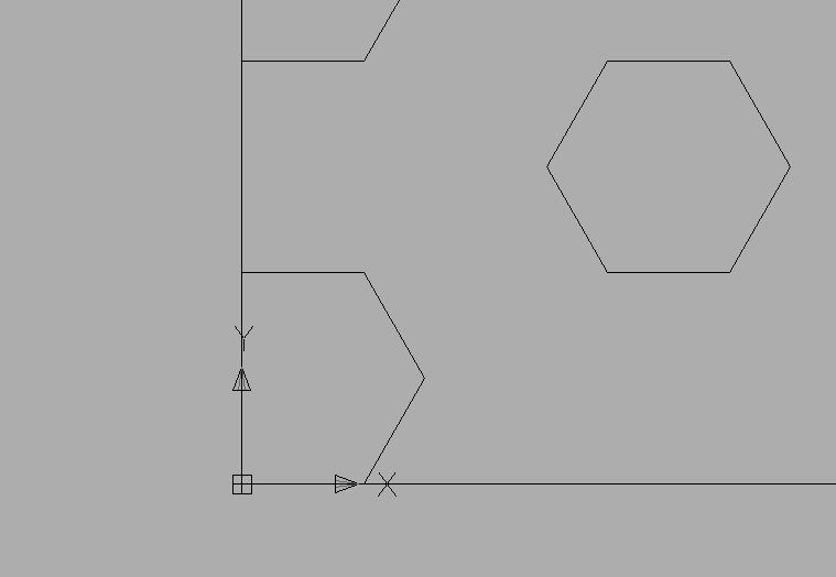

vernonlee Posted March 25, 2015 Author Share Posted March 25, 2015 Hi eldon, I did that but i click all four corners of the rectangle when selecting origin point, would not give me the same location. So which origin point should i click? If you draw ReMark's rectangle starting at 0,0 and with sides 5000, 5000, and then hatch it with the imperial hex hatch pattern at a scale of 500. You can now take this rectangle with the hatch, align it with your pattern and see exactly where the origin is (corner of rectangle). Quote Link to comment Share on other sites More sharing options...

eldon Posted March 25, 2015 Share Posted March 25, 2015 Hi eldon, I did that but i click all four corners of the rectangle when selecting origin point, would not give me the same location. So which origin point should i click? When you draw the rectangle with one corner at 0,0, you must mark that corner before you align it with your existing pattern, and then you will know where the origin point is. And then you can set up a UCS based on the rectangle, or whatever. Quote Link to comment Share on other sites More sharing options...

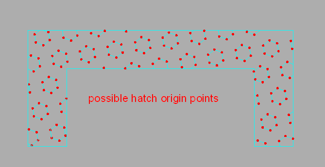

eldon Posted March 25, 2015 Share Posted March 25, 2015 Looking at the hex pattern, it is apparent that every single corner of the shape could be the origin point. Quote Link to comment Share on other sites More sharing options...
vernonlee Posted March 25, 2015 Author Share Posted March 25, 2015 When you draw the rectangle with one corner at 0,0, you must mark that corner before you align it with your existing pattern, and then you will know where the origin point is. And then you can set up a UCS based on the rectangle, or whatever. Ok. I I'll tests it out. Thanks Quote Link to comment Share on other sites More sharing options...

eldon Posted March 26, 2015 Share Posted March 26, 2015 I have marked all possible points of hatch origin on your original drawing. Quote Link to comment Share on other sites More sharing options...
BIGAL Posted March 27, 2015 Share Posted March 27, 2015 Eldon your correct, I cheated and tested the simple realign with NET making a pline corner the intersection of the hatch squares, again there has to be a rule of which corner point controls and what pt on the hatch matches, you can then work out a shift as well as the complication of the rotation angle, that was like version 4. Quote Link to comment Share on other sites More sharing options...
