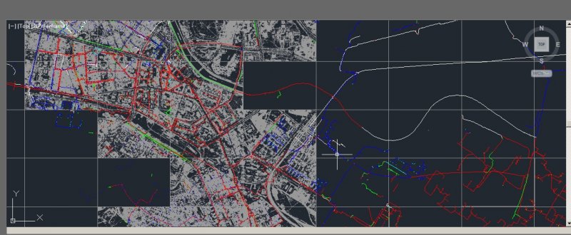

Dstojanoski Posted March 24, 2015 Posted March 24, 2015 Hello, I have problem with AutoCAD Civil 3D 2012, when I try to Save As (DXF R12/LT2 dxf (.dxf). When I choose to save in this Format, saving starts, and at the end of saving my AutoCAD crashes. I really need option to save in this format, because in that format I can Import documents to MapInfo 11.0 Anybody have problem with similar issue, how can I repair? Quote

Dstojanoski Posted March 24, 2015 Author Posted March 24, 2015 I tried all of your tips, but still same problem. I try to save with 2000 and it save, but R12 still not work. Quote

Dstojanoski Posted March 24, 2015 Author Posted March 24, 2015 Now i tried your metod, but still same problem. Two days ago I everything was okay, but I don't know what happens now, I have this version 11 months. I'll download another version and reinstall, thanks for tips and time people, I am sorry for disturbing. Quote
