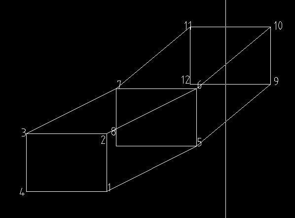

I’d like to know if you have one LSP that links points with some 3D POLY LINE between then.
Something like an outline, just like this:
It is link points given by coordinates. I upload from a device the coordinates and import points to AutoCAD, but I have to link them like the picture. It doesn't have an order, but the 3d lines are only the outside. It will be good if I can select them to link or even link by layer, because I work with tunnels and each point represents the edge of it.

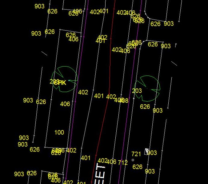

From a surveying sense and it will work in 3d you need to think of it as strings lets take a sq repeated horizontally the survey pts would look like this as descriptions
Num,X,Y,D,Desc
1,100,0,0.0,1F
2,100,10,10.0,1T
3,90,10,10.0,1T
4,90,0,0.0,2F
so 1-5-9 join 2-6-10 join its in the point descriptors "String description" all 1F join in sequence
String example.jpg See lines joined based on their code description a string numberis not displayed 01403 & 02403 to distinguish between kerb 1 and 2.
If you did all you points this way and brought it into CIV3d you would get a 3d tunnel. The way to go here to do some form of crossection linking back to the previous one using a pt&desc match as you go a new string would stop or start the joins.
