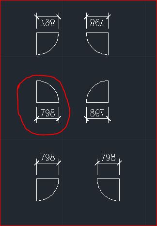

vernonlee Posted April 18, 2015 Author Posted April 18, 2015 Door dimension mirror issue.dwg Hi Dadgad. Attached is the door & dimension in a block. Quote
Dadgad Posted April 18, 2015 Posted April 18, 2015 If you explode the block before using the MIRROR command, the dimension will be correct. I exploded the red circled block before mirroring it down and across, where the dimensions are displaying properly. Quote
vernonlee Posted April 18, 2015 Author Posted April 18, 2015 If you explode the block before using the MIRROR command, the dimension will be correct.I exploded the red circled block before mirroring it down and across, where the dimensions are displaying properly. Hi Dadgad. Unfortunetly this is an existing drawings & are already drawn up as in there are about 300 door blocks of different type per storey. I am also not allowed to explode anything other than putting those dimension in. Any advise? Quote

Dana W Posted April 18, 2015 Posted April 18, 2015 Text objects, Dimensions, leaders, and attributes ignore the value of MIRRTEXT, even though it is set to 1, when the text objects are part of a block. MIRRTEXT is the system variable, that when set to 1 (default) will make text stay in non mirrored position even though they have been mirrored, UNLESS they are inside of a block. They are part of the block then. Think of a block as an image, rather than an editable set of geometry. You'd probably much rather have this version of your door block, with two flip actions. Select it, and click the blue arrows to see the miracle . You may have to adjust the position after you flip it, but the text does not mirror. Door dimension with two flips.dwg Quote

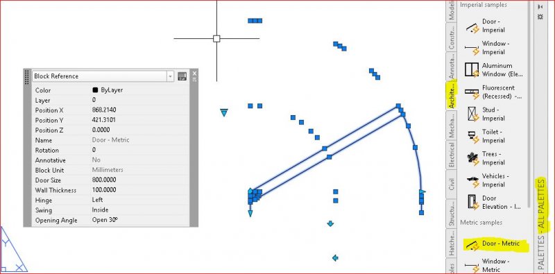

Dadgad Posted April 18, 2015 Posted April 18, 2015 (edited) Vernon, if you open your PALETTES and look on the ARCHITECTURAL tab, I believe you will find a dynamic metric door block with all the parameters ready to go, as well as a few others which you might want to know about. You could create a copy and edit it slightly, if you need to show 798, for instance as the block has incremental steps and one of them is at 800. That was just by way of moving information around, use the one Dana did for you! I just wanted to give you a heads up to the fact that you have a fair number of useful dynamic blocks included in your software. Having avoided the slippery slope of starting to teach myself about creating dynamic blocks coming up lunch time on Saturday, here I still am! Last Saturday I thought it was Friday and it wasn't until about 4:00 p.m., when responding to a I noticed what day it really was. The dangers of working at home, and waiting for our next tender to hit, and make us all super busy again! At least today, it is of my own doing, as I am fully aware that it is meant to be a day off. Edited April 19, 2015 by Dadgad Quote
