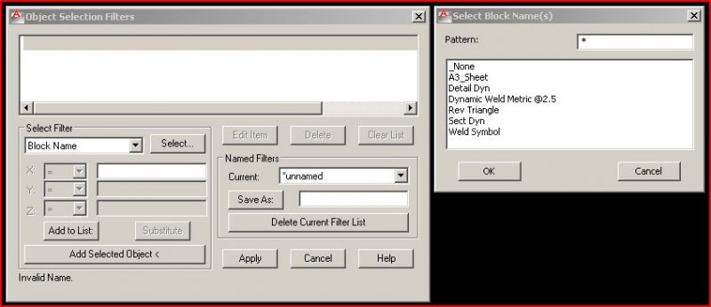

Dadgad Posted July 6, 2012 Share Posted July 6, 2012 The FILTER command also works well, and doesn't worry about layers, unless you instruct it to. A really good tool, especially if you save a few filters which you might like to use on subsequent occasions, making it faster still. Quote Link to comment Share on other sites More sharing options...
