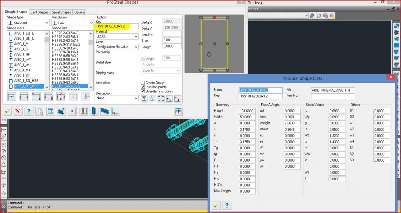

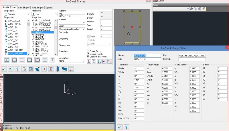

Dadgad
as you mentioned about the beam size bigal, could someone point me in the direction of a USA supplier of rectangle hollow sections? usually i use a 100X50X3 RHS but that is Australia standards.....
These screenshots are from the ProSteel database, I have highlighted an RHS very close to what you described, I hope that helps you.

bennyboy86
thanks for that, late yesterday open internet explorer (shocking i know).....and set google to search usa not aus and finally found suppliers, going with the 4x2x3/16 (inches) HSS..damn i miss prosteel loved using that

Dadgad
You probably know that section is about 50% thicker than the one you say you favor in Australia, and that even the 4x2x1/8 is slightly larger than your usual RHS profile. :|
