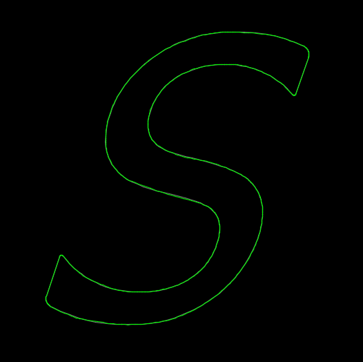

ReMark Posted July 17, 2015 Share Posted July 17, 2015 My attempt at reducing the number of polylines. See anything unusual? My letter "S" consists of 9 entities. When I made this image my letter was basically sitting over the top of yours. Quote Link to comment Share on other sites More sharing options...
