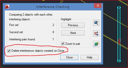

dannysteel Posted August 11, 2015 Posted August 11, 2015 hi guys i really need help with this project i'm trying to model the top tubes of this shade the material is hss(tube)4x4, i tried one curve but how do i integrate the other curve into the other for a good path?Canopy with measurements Jul 1 2015.pdf i would really appreciate your help thank you Quote

ReMark Posted August 11, 2015 Posted August 11, 2015 OK, I just opened your drawing. The first thing that comes to mind is extruding two profiles then using the INTERFERE command to obtain the shape you are looking to achieve. I have not tested the idea. Quote

ReMark Posted August 11, 2015 Posted August 11, 2015 I've attached a drawing which has a flared and arched beam constructed from some of your geometry to demonstrate that the shape can be derived from the intersection of two 3D solids using the INTERFERE command. Saved in AutoCAD 2010 file format. 3D Canopy Interfere.dwg Quote
