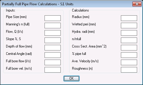

My ultimate aim is to give a better appearance to the dialog shown below:
Thanking in advance
You're talking about the layout of your dialog?
I would use 2 rows , each row containing 4 columns , 1 column for text , 1 for edit boxes , 1 again for text and 1 again for edit boxes. That way all your boxes align. Or you can use 1 row and 4 colums.
Gr. Rlx
Hi rlx,
As regards my aims, your first quote is correct. I want a dialog to appear as shown below after I run the lisp instead of nothing:

Here is the dcl for the above dialog.
aloy1 : dialog {

 ok_only;
I understand what you mean. I too, am familiar with C#, Java, .net etc. as I obtained Java's SUN certification many many years ago Creation of dialogs is very easy with them. I think there is need for interfacing with something like ObjectArx to implement dialogs with C# in AutoCAD which appears messy to me. Hence my attempt to go along dcl. I have the dialog of a digital terrain modeling with the program itself (dcl & lsp), sent to me by a contributor to this forum, which means what I am attempting can be done via dcl.
Regards,
Aloy
Aloy
Edited by rkmcswain
added [CODE] tags
Aloysius,
I suggest you read about "Nested Dialog" on Afralisp http://www.afralisp.net/dialog-control-language/tutorials/nesting-dialog-boxes.php.
Your alignment problem is cause by the width of your edit box tile being insufficient for the label and edit box. Normal way would be to have " alignment = right;", and the label left justified. So in other word the whole edit tile is aligned right but the label within the tile is left aligned by default. That is unless you have set fixed_width too small.
Not sure but I believe you want to input values and have the calculation updated every time you change any of the input. Upon pressing OK the dialog and program would be exited. This is possible with standard DCL
However a real floating window is not possible as rlx already told you.

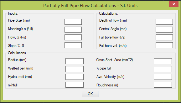

I've created some examples for you. Just to show what you can do
you can call them with aloy2 and aloy3 in the lisp file
have fun
p.s. I would give the edit boxes a more readable name.
gr.Rlx
aloy.DCL
aloy.lsp

I was able to slightly modify your code to get the attached dialog. However I could only see it in the preview. When the lisp is run. it is hidden somewhere; same as the TerryCad one given in my original posting in the thread. I also want to add a picture to explain the user what all there parameters mean as in the link link given for a free calculator:

:DHi Aloy,
I've created a few quick examples in aloy.lsp. How to init your edit boxes , to do something with your editboxes without closing the dialog (updating)
Just type something in for example pipe-size edit box or depth of flow and your edit boxes wil be updated (whith some bogus values)
The real calculations you have to do yourself of course. Point is how to asign a action to an editbox. Maybe study some examples on terrycad.
The values change when you type something in editbox and then go to another editbox (to trigger the action-tile) or press enter will do the job (as long as your ok button doesn't have dcl property allow_accept = true). Another way could be to add a botton 'recalculate' instead of only ok.
If you type 0 , 1 , 10 in slope edit box some other edit boxes will be updated , if you just click in one of the calculation editboxes upperright , all boxes will be updated , just for example. Current programm is purely example, no error checking , has no variables to store values for your edit boxes but i hope you dont hope i write the entire program haha
Pretty bussy for me this week , big shutdown in the plant I work , so you have to do some work too :D
btw, this is just tutorial as to how not to hide the dialog and how to use action_tile. Next step would be to create a function 'recalculate_dialog that would take the form (action_tile "eb_pipe-size" "(setq pipe-size $value)(recalculate_dialog)")
This way you can have 1 function to do all your calculations for all your edit boxes.
gr. Rlx

Hi Aloy
Hope you feeling better already:P
Had to break away from my work for a moment and made a few updates for you. I hope it is usefull / learnfull for you.
aloy.DCL
aloy.lsp
