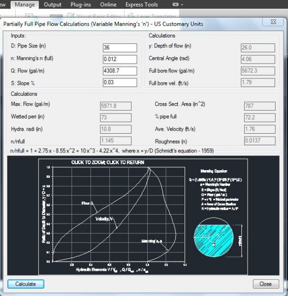

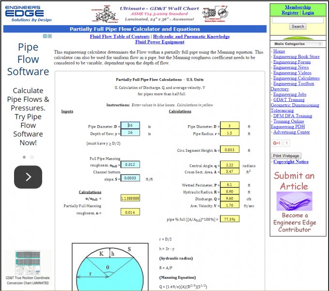

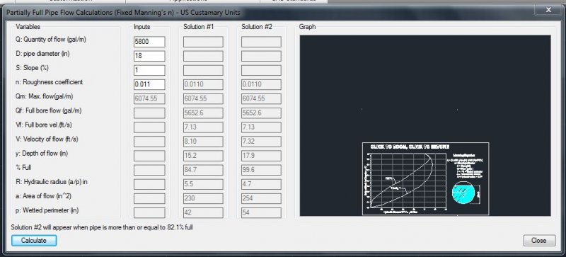

aloy Posted December 11, 2015 Author Share Posted December 11, 2015 Hi Rlx, My computer was down for some time before finishing off with this thread. I have been able to convert to US- Customary units as can be seen in the pictures attached. I have come up with another issue. That is the slide that appear for FixedN is too small. Is there any way this can be made bigger?. I attached the DCL also. For comparison of results for similar flows in another calculator that can be reached online I give their output as well. Regards, Aloy aloy2aim.dcl Quote Link to comment Share on other sites More sharing options...
rlx Posted December 11, 2015 Share Posted December 11, 2015 Hi Aloy , long time no see , glad you're still around :-) Height of your image in dcl is 20 , ratio 1.7. Try to make your ratio a little bigger. Better maybe make your slide a little smaller because you have one big fat (huge) dialog there :-) And allways make sure you have the correct slide when you have more then 1 version. You called your DCL Aloy2aim , then rename your lsp and your slide also to Aloy2aim so there can be no mistake , or, make sure the old versions are gone , archived , kaputt whatever. It can be very frustrating when you're testing , changing and testing again and again and see nothing changing because the file you're loading everytime is not the one you just changed (not that it ever happened to me , ahum...) And maybe remake your slide in a viewport that has the same ratio of your image as mentioned in some of the earlier posts. gr. Rlx Quote Link to comment Share on other sites More sharing options...

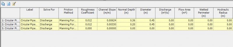

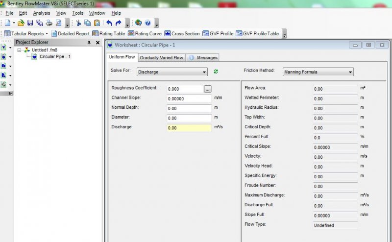

aloy Posted January 13, 2016 Author Share Posted January 13, 2016 Rlx, Thanks for the prompt reply. I attach some snipes of a state of the art package by a world renowned organisation. They gave me this package free of charge when I purchased a book on Modeling of Waste Water Systems a couple of years ago; it cost me around $270 at that time, if I am not mistaken. This package does not have the capability of analyzing with varying Manning number though. What I need to do is to have a similar format of the table to put in my variables attached to all the edit boxes in the dialogs. If I can do one, then can have the same method for other three dialogs as well. Regards, Aloy Quote Link to comment Share on other sites More sharing options...
