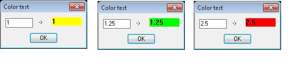

rlx Posted September 21, 2015 Share Posted September 21, 2015 (edited) Hi Aloy, well the answer is yes and no. The no part is for the editboxes in general. for the yes part take a look at this (defun c:coltest (/ dclp) (setq dclp (load_dialog "Cad-tutor-dcl-color.dcl")) (new_dialog "colortest" dclp) (set_tile "testimage" "123.45") (start_dialog) (unload_dialog dclp) (princ) ) colortest : dialog {label = "Color test"; : image { key = "testimage"; width = 10; height = 1.28; fixed_width = true; fixed_height = true; aspect_ratio = 1; color = 1; } spacer; ok_only; } got the inspiration from TerryCad btw... as i see it , it's a one way road. You set the color and stick by it or you would have to modify your dialog on the run. Or , you would have to use vectors to write to the image. I have seen Lee Mac doing it , can't remember which program , but it's a hell of a lot effort. Maybe some users at this forum have a better idea? gr. Rlx Edited September 21, 2015 by rlx Quote Link to comment Share on other sites More sharing options...
aloy Posted September 21, 2015 Author Share Posted September 21, 2015 Hi rlx, If it is difficult I wont attempt it. I actually wanted to give one color for the data and another for the results. It is already there anyway though not very prominent. As for the image I will get into it later as I intend giving a diagram giving description of all the parameter just like in the case of the free calculator which I gave in my earlier posting. Thanks for the help. Aloy Quote Link to comment Share on other sites More sharing options...
rlx Posted September 21, 2015 Share Posted September 21, 2015 Hi rlx,If it is difficult I wont attempt it. I actually wanted to give one color for the data and another for the results. It is already there anyway though not very prominent. As for the image I will get into it later as I intend giving a diagram giving description of all the parameter just like in the case of the free calculator which I gave in my earlier posting. Thanks for the help. Aloy Your quite welcom. Just for fun I updated previous routine to be able to show colors (defun c:coltest (/ dclp inp) (setq inp 0 dclp (load_dialog "Cad-tutor-dcl-color.dcl")) (new_dialog "colortest" dclp) (init-dialog) (action_tile "eb_input" "(update_dialog $value)") (start_dialog) (unload_dialog dclp) (princ) ) (defun init-dialog () (cond ((= inp 0)(setimagecolor "testimage" -1)) ((< inp 0)(setimagecolor "testimage" 1)) ((equal inp 1)(setimagecolor "testimage" 2)) ((and (> inp 1)(< inp 2))(setimagecolor "testimage" 3)) ((> inp 2)(setimagecolor "testimage" 1)) (t (setimagecolor "testimage" -1))) (set_tile "eb_input" (rtos inp)) (set_tile "testimage" (rtos inp)) ) (defun setimagecolor (im col / x y) (setq x (dimx_tile im) y (dimy_tile im)) (start_image im)(fill_image 0 0 x y col)(end_image)) (defun update_dialog (val / inp) (setq inp (atof val)) (init-dialog)) colortest : dialog {label = "Color test"; spacer; : row { : edit_box {key = "eb_input";} : text { label = " -> ";} : image { key = "testimage"; width = 10; height = 1.28; fixed_width = true; fixed_height = true; aspect_ratio = 1;} } spacer; ok_only; } just example how to color your output. gr. Rlx Quote Link to comment Share on other sites More sharing options...
