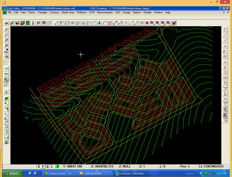

Rlx,
I can leave this issue as it does not affect my ultimate goal, that is to produce something like what can be seen in the third picture given below. Apparently it has been done using a dedicated CAD system. This is a drawing with a professional touch. I am sure this can be done inside autocad with our own commands (using the calculation engine) instead of buttons as shown here. Also the contours can be generated using the code given by the person who put in the post #10 in this thread. Those codes can generate contours on a set of points on an irregular grid unlike the square grid shown at the background of the first two pictures. Similar drawings for a Roads Network of a project (without using contours) has already been done inside autocad.
May be I will start a new thread for this exercise.
Regards,
Aloy

Gis etc is not really up my alley although yesterday I was simming trough some old lisp links and found some lisp programmes to generate such contours , but I have to look that up on my notebook at home. I'm sure if you start a new thread somebody somewere will have something to help you with that somehow :-)
gr. Rlx
