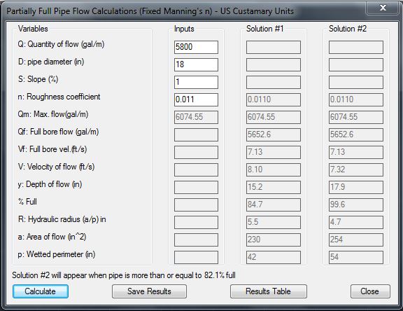

aloy Posted January 19, 2016 Author Share Posted January 19, 2016 Rlx, Another help please. I give below one of the four dialogs with calculated results on it. When I press "Save Results" the results will be saved to a list of lists and the results in the dialog disappears. Now I want to press "Results Table" to clear the dialog and bring the results table. That means the dialog can be closed both by "Close" and "Results Table" buttons. Is this possible. My attempts failed and could not find anything like that in the internet. Quote Link to comment Share on other sites More sharing options...
rlx Posted January 19, 2016 Share Posted January 19, 2016 Rlx,Another help please. I give below one of the four dialogs with calculated results on it. When I press "Save Results" the results will be saved to a list of lists and the results in the dialog disappears. Now I want to press "Results Table" to clear the dialog and bring the results table. That means the dialog can be closed both by "Close" and "Results Table" buttons. Is this possible. My attempts failed and could not find anything like that in the internet. Sure , when you press "Close" you probably do a 'done_dialog' with a integer , something like (done_dialog 2) and if you want the same effect when you press "Results Table" you would do the same but with a different code , for example (done_dialog 3). You capture this code usually with something like (setq drv (start_dialog)) , drv = dialog return value. And after the line with start_dialog you would use the 'COND' function to see which button has ended the dialog and what action has to be taken (cond ((= drv 2)(save & exit)) ((= drv 3)(show results table))). Hope this makes sense 2 you? gr. Rlx Quote Link to comment Share on other sites More sharing options...
aloy Posted January 21, 2016 Author Share Posted January 21, 2016 Hi Rlx, Seems to have not got it yet. For example following code got me spinning: (action_tile "table1" "(done_dialog 2)") (action_tile "calc" "(Calculate)") (action_tile "accept" "(done_dialog 1)") (setq drv (start_dialog)) (cond ((= drv 1) (unload_dialog Dcl_Id%)) ((= drv 2) (putTable))) (defun putTable() (results)) ; table1 = key for "Results Table" button ; 'putTable' is the fuction activated when "Results Table" pressed ; saving results ok Could you please advise?. Quote Link to comment Share on other sites More sharing options...
rlx Posted January 21, 2016 Share Posted January 21, 2016 Hi Rlx,Seems to have not got it yet. For example following code got me spinning: (action_tile "table1" "(done_dialog 2)") (action_tile "calc" "(Calculate)") (action_tile "accept" "(done_dialog 1)") (setq drv (start_dialog)) (cond ((= drv 1) (unload_dialog Dcl_Id%)) ((= drv 2) (putTable))) (defun putTable() (results)) ; table1 = key for "Results Table" button ; 'putTable' is the fuction activated when "Results Table" pressed ; saving results ok Could you please advise?. Hi Aloy , your code is essentially ok. Just put your (defun putTable () ...) outside the dialog handler routine just as any other routine and make sure all the dialog values are stored in the appropriate global variables so your table function can reference them. Is the normal way to go with your app to first press calc and then if the results are ok you press table? When your calculate function computes all the values for your table you must make sure you dont declare your variables in the calculate function as local variables because then your table function can't evaluate them. I also assume you use your calculate function to verify your data. You could include a global variable like 'table-data-verified'. This way your calculation function can set a 'flag' that the data is ok for use in your table. When you then call the table function you would have something like (if table-data-verified (putTable) (progn (alert "You must first use calculate to verify the dialog data")(return to dialog))). I guess your app is nearing completion? Although some apps are always evolving :-) gr. Rlx Quote Link to comment Share on other sites More sharing options...
aloy Posted January 21, 2016 Author Share Posted January 21, 2016 Hi Rlx, I have the following code: (defun aloy_dialogim () (new_dialog dcl-name Dcl_Id%) (aloy_init_dialogim) (action_tile "eb_pipesize" "(update_pipesizeim (setq dia $value))") (action_tile "eb_manning" "(update_manningim (setq man $value))") (action_tile "eb_flow" "(update_flowim (setq flo $value))") (action_tile "eb_slope" "(update_slopeim (setq slo $value))") (action_tile "save" "(Resultsim)") (action_tile "table" "(done_dialog 2)") (action_tile "calc" "(Calculateim)") (action_tile "accept" "(done_dialog 1)") (setq drv (start_dialog)) (cond ((= drv 1) (unload_dialog Dcl_Id%)) ((= drv 2) (putTable))) ) (defun putTable() (Resultsim1)) When "Save Results" pressed, the results are saved. When "Results Table" pressed the dialog disappears but no table. However when I invoke (putTable) a table appears without results. The results is an automation error that can be handled. Why the 'putTable' doesn't get activated?. I am referring to the table in the post #126 Quote Link to comment Share on other sites More sharing options...
rlx Posted January 21, 2016 Share Posted January 21, 2016 (edited) Hi Rlx,I have the following code: (defun aloy_dialogim () (new_dialog dcl-name Dcl_Id%) (aloy_init_dialogim) (action_tile "eb_pipesize" "(update_pipesizeim (setq dia $value))") (action_tile "eb_manning" "(update_manningim (setq man $value))") (action_tile "eb_flow" "(update_flowim (setq flo $value))") (action_tile "eb_slope" "(update_slopeim (setq slo $value))") (action_tile "save" "(Resultsim)") (action_tile "table" "(done_dialog 2)") (action_tile "calc" "(Calculateim)") (action_tile "accept" "(done_dialog 1)") (setq drv (start_dialog)) (cond ((= drv 1) (unload_dialog Dcl_Id%)) ((= drv 2) (putTable))) ) (defun putTable() (Resultsim1)) When "Save Results" pressed, the results are saved. When "Results Table" pressed the dialog disappears but no table. However when I invoke (putTable) a table appears without results. The results is an automation error that can be handled. Why the 'putTable' doesn't get activated?. I am referring to the table in the post #126 Hi Aloy, Little difficult without the complete program , but you could try the following : change your table action to (action_tile "table" "(Resultsim)(done_dialog 2)"). This makes sure you save your data before you exit the dialog. Secondly , you would typically set a break point (F9) in your visual lisp editor within the putTable sub routine , just before you create the table itself. The program wil halt execution there and then you can inspect if all the variables have been set properly. You have a list of data , does it contain all the values it should? Set a break point at the start of (vla-settext mytable row cell (car lst)) and inspect all your variables (watchwindow) : mytable , row , cell and lst or (car lst). Do they show the values you'd expect? If not , your data is not 'global' but probably saved in a local list or local variable? gr. Rlx Edited January 21, 2016 by rlx Quote Link to comment Share on other sites More sharing options...

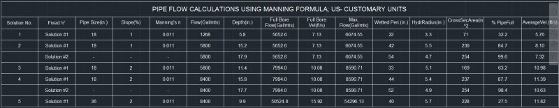

aloy Posted January 21, 2016 Author Share Posted January 21, 2016 Thanks Rlx, The problem solved. I left the "table" action same as before. However, changed the function definition for the dialog lisp as given below and I get what is given following table. I have also found that is very easy to format the table in exel the way we need after exporting to it. I therefore think that this product can be used for report writing for sewerage or drainage projects. Thanks for all the help I have received from you and others in this forum. With Best Regards, Aloy. (defun aloyim (/ Dcl_Id% eb-list) (aloy_initim) (load"pipeflowx") (load"FlowChecky") (load"pipeflowz") (load"MakeTableim1") (setq nr4 1 n nil lim nil) (aloy_dialogim) (putTable) (aloy_exit) (princ) ) Quote Link to comment Share on other sites More sharing options...

rlx Posted January 21, 2016 Share Posted January 21, 2016 Rlx,The code given in my previous post doesn't appear to work in the way intended. For example even if I ended the dialog with "close" button the table appears on the screen, which should not be the case. It should appear only when the "Results Table" button is pressed. When I checked its return value, it still is 1. I think these drv value fixing code needs further testing. Regards, Aloy Hi ALoy , that should not be too deficult. When you init your dialog add something like (setq I_WantToShowMyTable nil). Make sure you declare this variable in your main routine and not in the dialog sub. When you exit your dialog with code 2 , in the part with the (cond ((= drv 2) etc , add (setq I_WantToShowMyTable T) and then when you come to (putTable) in the main routine add (if I_WantToSHowMyTable (putTable)). Gr. Rlx Quote Link to comment Share on other sites More sharing options...
aloy Posted January 21, 2016 Author Share Posted January 21, 2016 Hi Rlx, I think I have got it corrected for now. Will check your method also. What appears to have gone wrong is I have hanged the "key" for the "Results Table" button as "table" as shown in post #130, though I have put it correctly in post #128. Obviously 'table' has a conflict with the autocad command "Table". Another thing I found out is that whenever a "key" is not defined properly for a button, it returns 1 when pressed. This caused the problem. After correcting it the dialogs work all right. I corrected the lisp code as given below. I give an autocad drawing for the results table for anyone to convert to excel. Will verify the accuracy of the results later. Regards, Aloy (defun aloyim (/ Dcl_Id% eb-list) (aloy_initim) (load"pipeflowx") (load"FlowChecky") (load"pipeflowz") (load"MakeTableim1") (setq nr4 1 n nil lim nil) (aloy_dialogim) (if (= drv 2)(putTable)) (aloy_exit) (princ) ) TableTry.dwg Quote Link to comment Share on other sites More sharing options...
rlx Posted January 21, 2016 Share Posted January 21, 2016 Hi Rlx,I think I have got it corrected for now. Will check your method also. What appears to have gone wrong is I have hanged the "key" for the "Results Table" button as "table" as shown in post #130, though I have put it correctly in post #128. Obviously 'table' has a conflict with the autocad command "Table". Another thing I found out is that whenever a "key" is not defined properly for a button, it returns 1 when pressed. This caused the problem. After correcting it the dialogs work all right. I corrected the lisp code as given below. I give an autocad drawing for the results table for anyone to convert to excel. Will verify the accuracy of the results later. Regards, Aloy (defun aloyim (/ Dcl_Id% eb-list) (aloy_initim) (load"pipeflowx") (load"FlowChecky") (load"pipeflowz") (load"MakeTableim1") (setq nr4 1 n nil lim nil) (aloy_dialogim) (if (= drv 2)(putTable)) (aloy_exit) (princ) ) okidoki... btw , thats why I label my tiles bt_myclosebutton , eb_myeditbox , tg_mytoggle , so I avoid any conflict and can see quickly what type of tile triggered an action. Also I try to use variable names in the keyname , tg_savetoexcel -> (setq Aloy-SaveTo Excel "1") where I use Aloy- (dash) as prefix for variables and Aloy_ (underscore) as prefix for function definitions , also to avoid any conflict with other loaded functions. To some this may seem to be a little over the top but if you write / use as many functions as I do you sometimes learn the hard way you know ;-) Gr. Rlx Quote Link to comment Share on other sites More sharing options...
