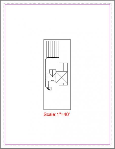

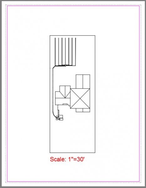

ReMark
The property as drawn at a scale of 1"=30' and 1"=40' for comparison purposes. The magenta colored line is a viewport and not a border. The viewport is created in the layout and acts as a window allowing us to see the geometry created back in model space. The text is both cases was placed in the layout and is 1/4" in height. The paper is 8.5x11 in portrait orientation. If you have any questions just ask.
Share this post

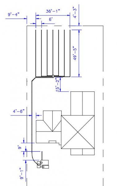

ReMark
A portion of the 30 scale version with a few dimensions thrown in for good measure (no pun intended) and the property line denoted using a different linetype. All dimensions were done in the layout using a text height of 3/23" (0.09375). 1/8" size text would have been too large in my opinion. Oh, and I changed the font from the default of Arial to something easier to read called RomanS. Arial is a TrueType font while RomanS is a standard AutoCAD .SHX font. I also changed a number of the Dimension Style defaults to make the dimensions look better.
Share this post

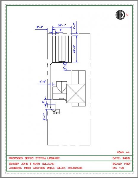

ReMark
Last one. I added a quickly thrown together title block, border and north arrow to give it a somewhat finished look. With the addition of any information the town specifically requires this could be submitted to the building department, town sanitarian, and/or planning and zoning.
Share this post
Link to post
Ski_Me
[ATTACH]55545[/ATTACH]
That looks pretty good ReMark. You should save that (except for the geometry) as a template and send it to the OP so he could use it for other projects.
