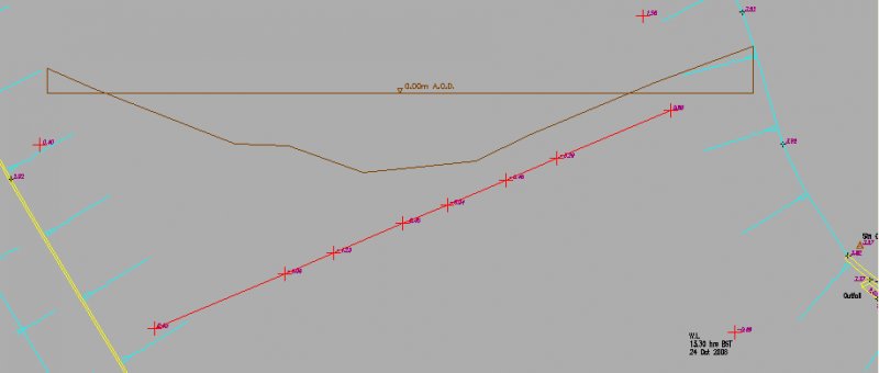

sayemabir Posted October 20, 2015 Author Share Posted October 20, 2015 Oh why not just reverse the normal. [ATTACH=CONFIG]55832[/ATTACH] How you do that? Quote Link to comment Share on other sites More sharing options...
BIGAL Posted October 20, 2015 Share Posted October 20, 2015 Easy Rotate3d pick cross section and realign using vpoint 1,1,1 so can see whats going on. Quote Link to comment Share on other sites More sharing options...
