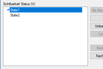

I have a dwg with a bunch of the same block in it (called Cabinet). This particular block has a number of visibility states.
I have assigned an attribute (called SetVisState) to the block that I can modify via ATTOUT and ATTIN. I want a LISP routine to check this attribute in each block, then update it's visibility state based on this attribute.
Unfortunately I have next to no experience with LISP, so any guidance would be appreciated. I have tried looking around this forum and others, but so far have only managed to run a LISP that checks the current visibility state and then toggles between states (I need it to check attribute value then change vis state accordingly). I tried Lee Macs code for getting attributes, but couldn't figure out how to apply that to my scenario either.
Thanks in advance.

Consider the following example:
(defun c:test ( / i o s )
   (if (setq s (ssget "_X" '((0 . "INSERT") (66 . 1) (2 . "`*U*,Cabinet"))))
       (repeat (setq i (sslength s))
           (setq o (vlax-ename->vla-object (ssname s (setq i (1- i)))))
           (if (and (vlax-property-available-p o 'effectivename)
                    (= "cabinet" (strcase (vla-get-effectivename o) t))
               (if (setq v (LM:vl-getattributevalue o "SetVisState"))
                   (LM:setvisibilitystate o v)
(vl-load-com) (princ)
You will need to first download & load the required attribute & dynamic block functions from my site.

Nomad
Thanks for the responses.
Lee, I haven't been able to get that code to work yet.
I copied the code above into a text file and renamed it Test.LSP. I then copied all of the subfunctions from the two links you provided beneath the provided code in the Test.LSP file. I dragged and dropped this file into the dwg. I typed Test in the command line. Literally nothing happens haha.
Am I doing something obviously wrong? Or should I start learning how to debug LISP haha.

Nomad
Lee,
I checked through everything again and it turns out I had actually named the block "Cabient" :oops:
Thanks so much for your help - it works perfectly.

I created an block named 'cabinet' with an attribute "SetVisState" with two values: state1 und state2
Then I drag an droped the test.lsp with the code up there into my DWG
and I got the following messages:
Command:(LOAD "C:/.../Desktop/test.lsp")
Command:
LM:SETVISIBILITYSTATE
Command:test
Found cabinet block "44D4".
Value of "SetVisState" attribute = State2
Unable to set visibility state to "State2".
Hm... what went wrong?

To get the obvious question out of the way, I assume that your block 'Cabinet' has a Visibility Parameter with a Visibility State called 'State2'?
Share this post
Link to post
Ecko
Yo that's right.
Visibility Parameter with a Visibility State called 'State2' and another one with 'State1'

dlanorh
Upload an example of your block so everyone knows what they are dealing with. It is near impossible to correctly diagnose a problem without seeing the "patient"
Share this post
Link to post
dlanorh
The problem is the block is called "circle", not "cabinet". Either rename the block "cabinet" or change every instance of "cabinet" to "circle" in the lisp.
Just noticed you have a "cabinet" block. When this is used the lisp works. If you don't have all the required "bits", I've attached a complete lisp and your drawing set up to test.
test1.dwg test.lsp
