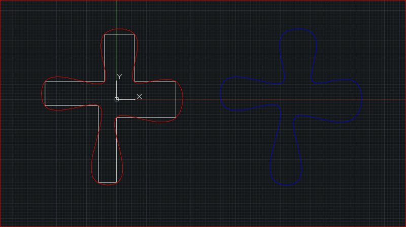

SEANT Posted March 8, 2016 Share Posted March 8, 2016 As a test, what shows up in your CAM software after importing this file? SplineConversion.dxf Quote Link to comment Share on other sites More sharing options...

lrm Posted March 9, 2016 Share Posted March 9, 2016 We need to think of AutoCAD as having two type of splines, “old” splines and “new” splines. An old spline is created by using the spline option with a polyline (PEDIT S). A “new” spline is created with the SPLINE command. The old splines are mathematically known as B-splines and the new splines are NURBS (non-uniform rational B-splines). The red spline in your drawing is a new spline. Your goal is to make an old spline from a new spline. To do this we need to know the location of the Control Vertices (CVs) of the new spline. To see the location of the CVs select the spline and click the pull-down (red down arrow). Note that Fit is checked. This was the method used to define the spline. Change the method to Control Vertices and you should see something like this. We now want to create a LWPolyline using these 7 CVs. I do not know a method for using OSNAP to access the CV’s so we can use the LIST command to get the CV coordinates. Command: LIST Select objects: 1 found Select objects: SPLINE Layer: "SPLINE" Space: Model space Handle = 1b0 Length: 3065.2641 Order: 4 Properties: Planar, Non-Rational, Non-Periodic Parametric Range: Start 0.0000 End2970.0202 Number of control points: 7 Control Points: X = 541.6263 , Y = 768.4563 , Z = 0.0000 X = 621.0883 , Y = 1130.7741, Z = 0.0000 X = 803.7368 , Y = 1963.5846, Z = 0.0000 X = 1615.7148, Y = 263.7842 , Z = 0.0000 X = 2083.8971, Y = 1586.3669, Z = 0.0000 X = 2443.1443, Y = 1280.3963, Z = 0.0000 X = 2561.1183, Y = 1179.9179, Z = 0.0000 You can type these coordinates in to create the polyline or use notepad to create a script. I created a script file that looked like this. pline 541.6263,768.4563 621.0883,1130.7741 803.7368,1963.5846 1615.7148,263.7842 2083.8971,1586.3669 2443.1443,1280.3963 2561.1183,1179.9179 The file is a text file but has the extension .scr. The file starts with the pline command. Make sure there are no blank characters and that there are two blank lines at the end of the file so the pline command will terminate. Use the SCRIPT command to create the polyline. You should see something like this. Using PEDIT with the S option will convert the polyline to a spline and will look something like this. Notice that there is a difference between the two splines. This is because some of the NURBS parameter values (not the location of the CV values) used in the creation of the new spline (red) are not compatible with the pline spline. The slope at the beginning at end of the spline should be good. We can fudge the shape of our pline spline to better approximate the orginal by moving some of the CVs (but not the first two or the last two). For example, moving the 4th CV up a bit will provide a closer match between the two splines. Here is the final result. Your CNC machine should be able to handle this “old” spline. Delete the original red spline and check it out. Note, fi you would rather not go through the hassle of creating a script file you could just create a polyline of where you think the CVs should be. You can use OSNAP END for the start and end of the polyline. Note that the location of the second CV defines the slope of the spline at the beginning. Its distance from the spline start defines the radius of curvature at the start. Take a guess where the other CVs are and then modify their location as needed. With a little practice you will get a good feel for where the CVs need to be. Good luck. Lee spl2arcs-lee.dwg Quote Link to comment Share on other sites More sharing options...

SEANT Posted March 10, 2016 Share Posted March 10, 2016 Even if the processing software balks at the format, try importing to your illustration software. This is what I get when importing to CorelDraw 12. The curves on the left - the original AutoCAD spline - looks like it might be problematic. The subdivided group of curves on the left look like native CorelDraw curves. If your illustration software native curves work well with the CNC processor, then perhaps these will as well. P.S. Maybe a CorelDraw - Arrange - Combine would further assist the process. Import.zip Quote Link to comment Share on other sites More sharing options...
