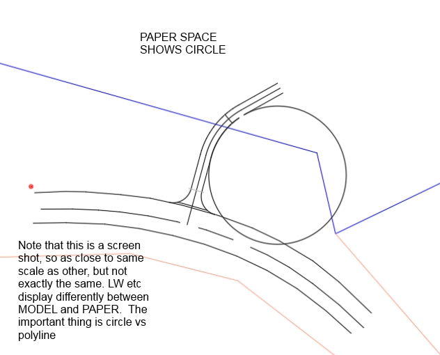

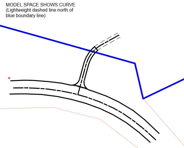

HFBandit Posted May 2, 2016 Share Posted May 2, 2016 Hi all I'm working on some information that I have imported into LT 2017 from 12D survey software. Basically I have a road string (polyline made up of arcs) and I'm tidying it up. All I have done to this string is break it and change the layer it is on. When I go into Paper space and look at my plan layout, the broken polyline displays as though it is a full circle. In Model space it looks how it ought. I have double-clicked in the viewport and selected the circle and changed the colour for easy identification. Then, when I go back to Model space, I have a red curved polyline. No circle. I have also tried copying the polyline as a block and pasting it into paper space. It displays as it ought to. If I paste it back into Model Space, it retains its characteristics - i.e. curve in model space, circle in paper space. If I explode the polyline into its component arcs and join them together again, it begins to behave properly. This never used to happen in prior versions of CAD, and my co-worker has had a similar problem. She says it's not a consistent fault - sometimes the display behaves and sometimes it doesn't. I have run audits and purges and all sorts of fun things and have achieved nothing. It prints correctly, but the preview shows it as a circle also. Any ideas, or similar issues? Quote Link to comment Share on other sites More sharing options...
SLW210 Posted May 2, 2016 Share Posted May 2, 2016 Can you post a portion of the file that does this? It would also be helpful if you posted both screen shots at the same zoom level and kept the same colors. First thought would be a graphics display problem, what are you Computer Specifications? Quote Link to comment Share on other sites More sharing options...
Dana W Posted May 2, 2016 Share Posted May 2, 2016 Using AutoCad LT 2016 at work. Before I changed from the onboard video processor, to an aftermarket one, I often had the inverse side of an arc (the missing part of the full circle) appear rather than the arc as drawn. This looks like what is happening. My instances would occur in modelspace when the actual arc(s) were near the edge of the display screen. They'd usually disappear when I changed the zoom or pan. They never plotted incorrectly, and have gone away with an extra 4 gig of dedicated RAM for graphics. Quote Link to comment Share on other sites More sharing options...
HFBandit Posted May 3, 2016 Author Share Posted May 3, 2016 System info, trimmed file and clearer screen shots attached. System.txt file.dwg Quote Link to comment Share on other sites More sharing options...
