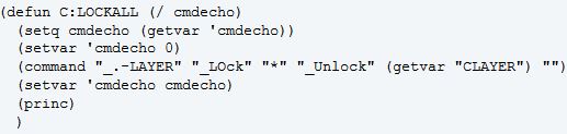

samifox Posted May 24, 2016 Posted May 24, 2016 hi im trying to create a button in the tool palatte to excute a script to freez all selected objects ^C^C-layer lo when typing its ok but as a script it doesnt excute the order. any idea? Quote

samifox Posted May 24, 2016 Author Posted May 24, 2016 put it simple Command: -layer LO (enter)(enter) works great Macro : ^C^C- -layer LO (space)(space)not working Quote

samifox Posted May 24, 2016 Author Posted May 24, 2016 Try removing the ^C^C which is probably canceling the selection. Sorry I haven't tested any of these, just speculating! -layer LOck no its not. typing in the commandline is not the same like excutuing the same in the macro, autocad thinks -layer LOck is terminated after the macro ends while its not. Quote
tombu Posted May 24, 2016 Posted May 24, 2016 Tested this macro on selected lines: ^C^C^Pqaflags 1 -layer LOck;;P;;;qaflags 0 and it will lock the layers of preselected objects. Quote
