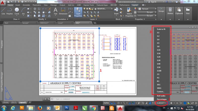

I have a three drawings all on the same page at 1:1 scale.
I am needing to print these three drawings onto an A3 piece of paper all at different scales. I was wondering how I am able to do this.
I have a vague understanding that I need to use viewports? - I have my screen in layout set to three sections, however I am unsure of where to go from here!
Really appreciate any help!
Thanks

Toggle each viewport and do as follows.
