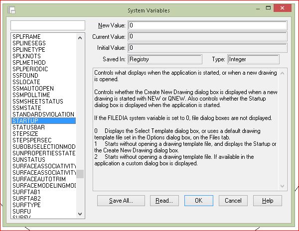

Are you sure that is the template set to open as Qnew?
Isn't _ClosedBlank the name for one of the arrowhead blocks that is a part of AutoCAD?
I opened your template but did not see a layer called BASE listed.
I suggest that in order to confirm that it is you open OPTIONS, on the FILES tab, select TEMPLATES, click on the Default QNew option there and browse to be sure which is your current default QNEW template.
Once you are sure which one it is, you can open the .dwt file, and purge it.
The dwg file which is generated upon opening your Autocad, is not created from the specified QNEW default template.
Sounds like that may be what is giving you the run around, that or as SLW implies, your default template is not the one you mean to, or think you are using. :beer:

With regards to QNEW and opening the right template, yes this is definitely the correct one set up in the Options tab.
If you look in the DimStyle dialog box on the Symbols and Arrows tab under the heading Arrowheads and click on the down pointing arrow for the first entry you will see that "Closed blank" is a listed arrowhead style that comes standard with AutoCAD. My advice would be to ignore it. In the scheme of things it matters not one iota.
