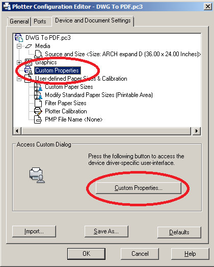

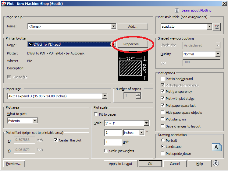

tazdog Posted July 25, 2016 Share Posted July 25, 2016 AutoCAD LT 2015, Windows I have detailed a part 1 to 1, used a new layout in paper space. Changed it to Arch 24x36 size. Created a window the full size of the 24x36. Scaled the part to the size in model space so that it would fit it to the full size of the drawing. In the plot setting I selected my printer, made sure that the paper size is 24x36 and that it is printing the layout and 1 to 1. I run a preview and it shows that it is taking up the full print page. When I print it only uses a 1/4 of the page!!! What am I doing wrong please??? Quote Link to comment Share on other sites More sharing options...
SLW210 Posted July 25, 2016 Share Posted July 25, 2016 You need to check the properties, then custom properties for the plotter in the plot manager. Quote Link to comment Share on other sites More sharing options...
BIGAL Posted July 26, 2016 Share Posted July 26, 2016 2nd what SLW210 has said, we have a printer send a A4 but it prints it true size on a A3 beacuse we told it to use the A3 tray not A4 tray. Quote Link to comment Share on other sites More sharing options...

Ski_Me Posted July 26, 2016 Share Posted July 26, 2016 Ok wait I think I read this wrong the OP said that when he printed it only used 1/4 the page meaning that even though he selected a 24X36 page size the printer page size was wrong so SLW210 and BIGAL were right but left out the part where he needs to check the properties of the plotter itself. Even though you pick your size paper in the plot manager and which plotter to use doesn't mean the correct paper size is selected at the plotter. This is why I always export to PDF then print from Adobe that way I have to check and select the correct paper size for the plotter. Quote Link to comment Share on other sites More sharing options...

SLW210 Posted July 27, 2016 Share Posted July 27, 2016 We already arrived at a solution. See post #2 for solution, adjust the settings in the Plotter properties, most likely paper size/orientation. Quote Link to comment Share on other sites More sharing options...

Ski_Me Posted July 27, 2016 Share Posted July 27, 2016 He can check the custom properties all he likes but if it is a networked printer then it's likely somebody sent a print job to that printer and set it for a different size paper. I'm saying that he needs to check the print drive directly not through auto cad. Quote Link to comment Share on other sites More sharing options...
