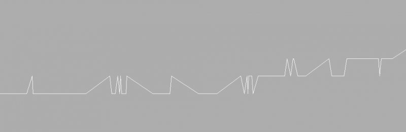

cat3appr Posted July 28, 2016 Share Posted July 28, 2016 hi all, I have this drawing, 12MB, so it can be downloaded here. I worked on it a lot and i want to improve it a bit. I tried with overkill bit it keeps on crashing, not sure why. can someone give it a try? i just don't want to purge empty layers yet because I still didn't finish with it many thanks! Quote Link to comment Share on other sites More sharing options...

ReMark Posted July 28, 2016 Share Posted July 28, 2016 I isolated the layer for the seabed. It has seven polylines on it. After exploding all seven polylines there were 162,076 individual lines. I'll bet that exploding the BOP and TOP layers will report back similar information. That's one reason why the Overkill command will appear to have crashed AutoCAD but in a test of one of the seven polylines on the seabed layer Overkill did work but it took over 15 minutes. To run the command on the entire drawing you would probably have to leave your computer running overnight and hope that when you come back in some 12 hours+ it completed the task. Oops, forgot to mention the result of the overkill command. AutoCAD reported back "0" duplicate objects and 86,845 overlapping objects. And this was for the shortest polyline on the seabed prelay layer, second row, first polyline on the left. Quote Link to comment Share on other sites More sharing options...
eldon Posted July 28, 2016 Share Posted July 28, 2016 In your drawing, you have four profiles, which are duplicated and split up into the four charts. I exploded all these profiles and there are 645,593 individual lines. You do not need to map every grain of sand or lump of rock. Whoever took the profile readings should curb their enthusiasm Quote Link to comment Share on other sites More sharing options...

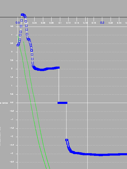

cat3appr Posted July 28, 2016 Author Share Posted July 28, 2016 In your drawing, you have four profiles, which are duplicated and split up into the four charts. I exploded all these profiles and there are 645,593 individual lines. You do not need to map every grain of sand or lump of rock. Whoever took the profile readings should curb their enthusiasm ok thank you! look this is the file that originates the profiles ; the green tube is the TOP column, all the profiles are ordered by KP (kilmeter post) but the company expressed it in meters (pretty stupid ) which in reality a KP should be indeed expressed in kilometers, so 0.001 = 1m, so i added a column B where I divided column A by 1000. the seabed starts at KP 0.124 ( after 124m) indeed i agree! i don't need all these points... now my dilemma is: i was given those profiles as already done... i wouldn't know how to plot them again from a smoothed / reduced version of this file.... any idea?? I isolated the layer for the seabed. It has seven polylines.....(/cut) ok thanks a lot ReMark, we have established that these profiles are WAY too heavy... so how to reduce them in a good manner to be plotted for this 1:2000 scale? Quote Link to comment Share on other sites More sharing options...
