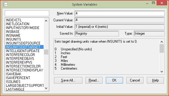

rhbelter Posted August 9, 2016 Posted August 9, 2016 Ahoy, Autocad, Not 'new', just not very 'accomplished'. I have a .dwg with blocks which are OK on the existing drawing, but a re-insertion has them becoming immense. Pop-up shows: units: unitless conversion: 6336.0000 followed by a litany of 'specify ... I have tried and have reset 'insunits' to 1. The upper menu: insert: Blocks: show Block unit Unit: 'inches' Factor: 1.000 A block which is immense on insertion, but OK on the existing .dwg, if exploded, re-named and created as a new block re-inserts OK. What now??? Thanks /s/ Bob Quote
rhbelter Posted August 9, 2016 Author Posted August 9, 2016 Ahoy, Autocad, Minor correction: the number above is: 63360.000 (which IS even more immense). Same problem on other drawings on Autocad 2016 Enjoy /s/ Bob Quote

Dadgad Posted August 9, 2016 Posted August 9, 2016 It doesn't appear to have been scaled in model space. When I insert the pilot into an Autocad Imperial inches template, he comes in pretty close to 6 feet tall. Quote
rhbelter Posted August 9, 2016 Author Posted August 9, 2016 Ahoy, Dadgad, Please see my comments to ReMark. Strange behavior, and I'm not clever enough to fix it. Thanks /s/ Bob Quote
rhbelter Posted August 9, 2016 Author Posted August 9, 2016 Ahoy, Dadgad, It was, and is set to 1. Thanks /s/ Bob Quote
