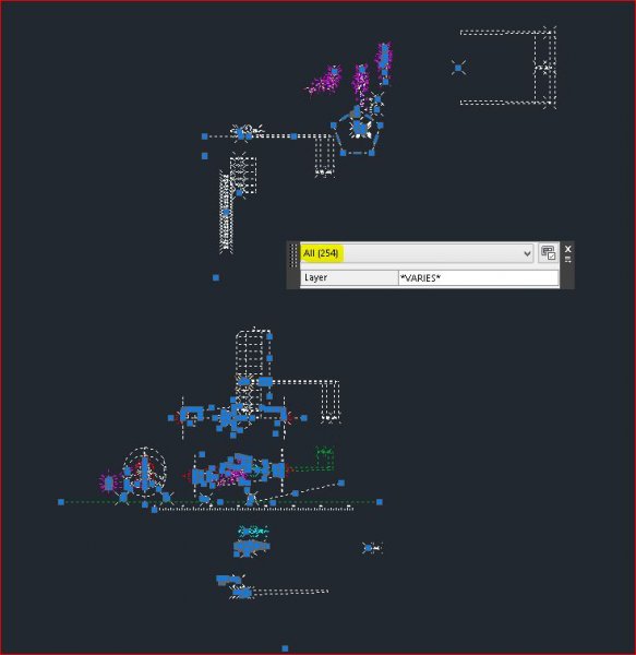

When you earlier said IMMENSE, you mean it LOOKS immense?
As when I select everything in your original drawing it is only 303kb, and contains 101 blocks and assorted other stuff?
So, I could use some clarification?
FWIW, one mile is 63,360 inches, so somewhere you're mixing miles and inches.

Thank you! Thank you! Thank you!
You solved the problem. When I go to Format: Units: Insertion scale: enter 'miles', block entry goes just fine. Measurements are now correct. If I insert a block, explode it, rename, and re-create it, re-insert it, becomes correct in dimension.
I open other files, and the 'Insertion Scale' is 'unitless'. Same effect -- immense blocks. Change to 'Miles', and OK.
Now: My question: What happened, and why, and why does it work now? ---- Too clever for me.
Enjoy /s/ Bob
You should familiarize yourself with the -DWGUNITS command.
It provides a one stop service for sorting out such anomalies, by consolidating all of the related and relevant commands into one concise sequence of commands, instead of randomly jumping aroung between the different commands.
Create a copy of your file to experiment with.
Then either stretch your commandline history up, so that it will display about 10 or 12 lines, or hit F2.
Then start -DWGUNITS at the commandline, and pay attention, read the commandline prompts carefully, because this command can really do it all, including scaling the entire data base if need be, AND you tell it to.

In my experience 99% of the times when an object comes in at what seem to be the wrong size the cause is a units mismatch. I probably know or can recognise the most common ones: 25.4, 1000, 304.8 (millimetres mismatches with inches, meters, and feet, respectively) so I thought a quick google of "what unit is 63360 time bigger than what unit" was worth a try. Once you know the mismatch is miles/inches you know what setting to change. If you're going to be using these blocks in future (or perhaps even as a learning experience) it's also worth looking into the absolute number - the difference between inches and miles is extreme, so I'm going to use inches and feet as an example. Basically you can probably tell instinctively whether an object you've just measured at 1.5 units is supposed to be 1.5 inches or 18. From that you can learn whether you need to just switch the units, just scale the object or do both.
As for why things like this pop up: the reason is largely historical. Units only appeared in AutoCAD relatively recently ('96, I think). Before that everything was unitless. Because drawings, settings, and standards get handed down from user to user weird discrepancies like that (my firm, for example, draw site layout in meters with the units set to millimetres) also get handed down.

Typically when I receive a drawing from someone else, I will run the -dwgunits command, since looking at the information it displays you can see what the database is, meaning metric or Imperial, and what the units are set to, inches, feet, yards, and yes MILES are all imperial, but if one fails to pay attention, things cn get a bit out of hand. :)
You will also be asked if you want to scale objects on isertion, which if you are working with Unitless blocks, is probably not a good idea.
If there is a need the entire Data Base can be rescaled too. Maybe you realized you had done it on a metric mmbased template, and you wanted it to be in units of a mile, a foot, inch, or whatever you could tell it to fix the whole database to comply with the intended units.
