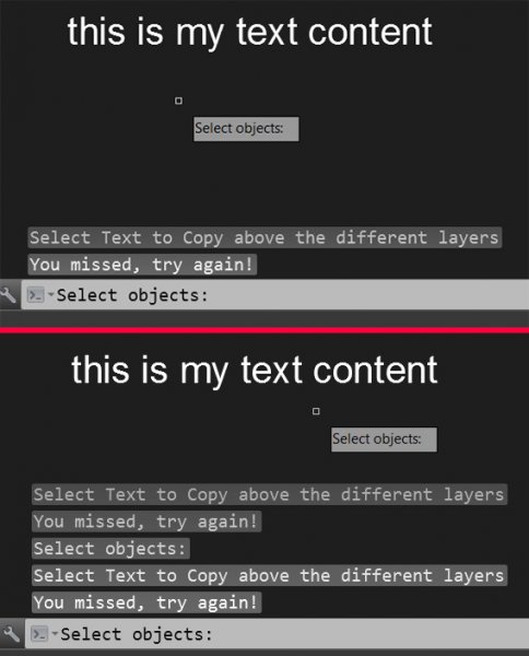

Still theres a issue, since the user can't exit the selection loop by pressing ENTER .. but I'm lazy to figure it out.

Btw I have everytime this "exit with enter" issue, while forcing the user to select.
Unfortunately from where I write these codes, I can't test this behaviour (although I try any kind of checks like: vl-catch-error-p sslength (= 'pickset (type ...)).

I use clipromptlines to strip out the unneeded lines from the console, while the user is prompted for the selection.
Usually I prefer this variable to be at value 4 (for any AutoCAD command-call prompts),
but while using the code I posted, its enough to be at value 2, otherwise
one may be spammed with "Select Objects:" and "Select Text to Copy above the different layers" messages:
