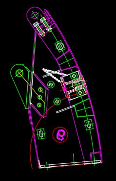

jim78b Posted October 3, 2016 Author Posted October 3, 2016 What i wrong in this file ?is it normale that Regen And refedit are slows? Quote
RobDraw Posted October 3, 2016 Posted October 3, 2016 There is no quick answer at this point. Here is what I would do and it would probably take a long time. I would start breaking down the file into chunks to see if the performance improved on some parts and not others. If there is an improvement on all parts as it is broken down, I would chalk it up to too many objects. If the problem can be isolated to one part of the drawing, that is where I would focus my efforts. Quote
ReMark Posted October 3, 2016 Posted October 3, 2016 I think part of the problem can be traced to objects that are far off in space and lie either above or below the Z elevation of "0". In other words, your 2D drawing is actually 3D. Quote

ReMark Posted October 3, 2016 Posted October 3, 2016 Not all that slow on my machine once I got rid of the few objects I previously mentioned. Quote
RobDraw Posted October 3, 2016 Posted October 3, 2016 Audit took about 10 minutes for me but I have not deleted those blocks that were off in space for you because I am not getting that and am assuming they are a viable part of the drawing. Quote
ReMark Posted October 3, 2016 Posted October 3, 2016 (edited) There are 159 blocks with the name cas_9 way off in space if viewed in a SE isometric view. In reality their Z coordinate is extremely large. They look like this and are quite small in size compared to many of the other objects in the drawing. They are on layer 3. Interesting. I copied and pasted a cas_9 block into a new drawing. The circle with the number in it has a Z of 0.00 while all the geometry has a Z of -1509910690.00. Edited October 3, 2016 by ReMark Quote
RobDraw Posted October 3, 2016 Posted October 3, 2016 That would explain why I didn't see them. I only looked at the top view. That could also explain the lag. AutoCAD does have troubles when you get that far from (0,0). @jim78b, Since this is a 2D drawing, all objects should be at Z=0 no matter what your opinion is about your hardware. It's just good drafting and in this case, since you are so far from 0, it could be the cause of the lag, Quote
ReMark Posted October 3, 2016 Posted October 3, 2016 (edited) The level of fine detail and the amount of cross-hatching could account for some of the lag too. For example re: fine detail, the block muletto_1 (fork lift), all the geometry that looks cross-hatched is actually filled in with a series of individual lines which even includes the word DREXEL. If you are going to be working with these types of drawings on a more frequent basis I'd look into increasing the amount of RAM in your computer by another 8MB to bring it up to 16MB. I'm running 12MB versus your 8MB so that may explain why the lag time for me was somewhat less. Edited October 3, 2016 by ReMark Quote
