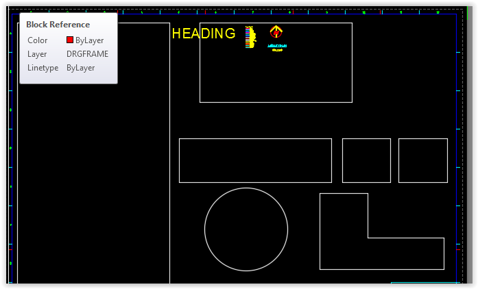

BIGAL
I do not see a problem just use mview in a layout I think you need to learn more about multile viewports in one layout and using scales of viewports.

BIGAL
This question has been asked again in another post today so I am thinking about it if I can find some time.
As I have said previously it can be done manually very quickly using zoom centre and a plot scale requires only 1 pt but you then drag the mview limits to suit.
