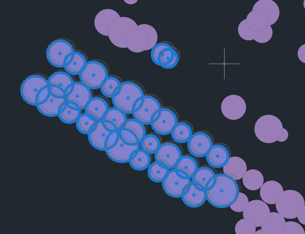

This has got to exist somewhere but after thirty minutes of searching I'm coming up empty. I tried Lee Mac's Point Manager program but without success.
What I'm wanting to do is insert a block at the geometrical center of a large selection of various blocks.
To be more specific, I have many different blocks that represent HVAC ceiling diffusers. These blocks range from size, shape, name, etc. and most of them are Dynamic Blocks. All of these must be labeled, in which yet another block is used. This label is the same block for each one. So if I have a drawing with 500 different ceiling diffusers, I just want to select all these blocks, click a button and the Ceiling Diffuser Tag (which is a block with three attributes) are all placed at the center. I will then go back and shift them all to the side, and edit them one by one. This just speeds up the process of manually copying them all around a drawing.
Anything out there that does just this? Or can Lee Mac's Point Manager program do this, chalking my unsuccessful effort up to "user error" lol? Thanks in advance!
-TZ

Assuming I've understood, here is a quick example using some existing code:

Perfecto, Lee!
I can use this program exactly as you have written it. If you would ever be interested in developing this program more for others to use, a few things I would suggest would be the current entity properties of the selected block (Color, Linetype, Layer, etc), Scale and Rotation.
Again, I can certainly use the program exactly as it stands since the above mentions can be achieved easily through QSelect and Properties Palette.

Hi! Lee.  First of all, sorry for bringing up this thread back. Second, Thanks for your generosity in sharing your code to all of us, it helps us a lot in our AutoCAD workflow.
I just have a question to ask. I hope this is not too much to ask from you. What if I need to Insert a Block at Block Insertion point not at the center, what will be the code to use?
Thanks in advance, and I looking forward for your answer.
Update the first part

I'am currently searching for a new Workflow in GIS work with treepoints from opendata. Is there away to adapt this lisp to insert a circle as block (tree) according to the median diameter of all closed and selected polygons? I cant figure out how QGIS is exporting real circles. The Export gets very nastily shaped (+100 Points per Object) and my .dxf gets very slow..
Thanks in adanvance for any reply
Jens
what you are describing sounds like 100 little polylines that make a circle. can you upload an test with a few different circles.
After a night's long odysee I finaly managed to create Circles with Logarithmic Randomized Diameter/Radius based on a Utm Point, and Diameter-Attribute-Field Export from Qgis within AutoCAD. Problem solved.
QGIS Dxf Translators are not able to manage true Autocad Circle Geometry Export from Symbology (as far as I came to understand). The circleshape geometry is exported as approximation in variant depth, thus incorporating a huge volume of polydata. If merging this into a whole Urband Map, no normal Computer can compete.
Unfortunately various scripts and lisps are from scratch not able to transform non centered polygons (due to QGIS Export)  into circle shapes within Autocad or approximational lisp approches f.e. Mac lee's algorithm is not able to transform multiply objects. This is necessary when its needed to transform some 100.000 treeshapes. If a solution occurs, I would still be happy to apply it since scripting from .csv export is time consuming. :)
P.S.: This is the .scr Format, which works for me in Englisch Programm Language
