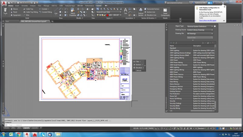

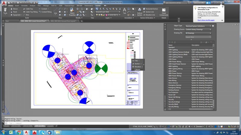

I am just going through changing the scale of my drawings and for some reason the objects in my model space are now coming up huge in the paper space!?
The model space is set to 1:1
I have also gone through and changed all the paper space views with viewports to 1:1
I am really not sure what is wrong I have attached some pictures to make it a little clearer.
Any help would be really appreciated
Are you using annotative scaling?

Im trying to scale one of my drawings to 1:150 @ A1 but its just having none of it. Every time it attempts it the paper space goes from the first picture to the second picture (below)

Every time i try and scale something on the paper view to 1:150, all the text and objects go massive and bunch together on the model as you could see from the previous image I attached. However when I flick back to the model its all fine so I'm going to guess it has something to do with the scaling on the paper view but I have no idea what

When I activate the viewport in the layout previously mentioned and I check the scale it is not set to 1:150 rather it is shown as a percentage with the value of 0.003424. If I check the Properties palette and look under the heading Misc.(at the very bottom) it lists an Annotation scale of 1:50.

STOP! I may have inadvertently solved your problem.
This is what I did. I opened the drawing and activated the viewport. Next, I opened the Properties palette and went down to where it says Annotation scale and changed it from 1:50 to 1:1. I then changed the viewport scale to 1:150. I repositioned the drawing in the viewport then I locked the viewport display so that I wouldn't accidentally change the viewport scale as I popped into and out of model space via the layout. Try it and let me know if you are successful.
