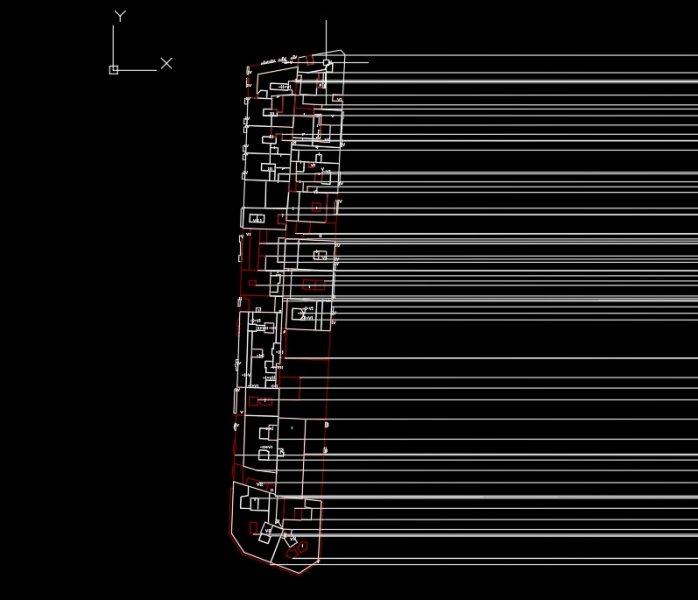

IT WORKS! well, kind of, I'll explain with images.
First of all, with too many polys it breaks, it says "too many intersections" (something along those lines, my autocad is not in english). So I have tested with around 200 polys.
And then there is something going on with the zoom level. When I zoom to the extent of the drawing, this happens:
If I zoom out a little, there are less of those lines, but it still doesn't work.
I I zoom really far out, then it works (I have given each layer a color for clarification):
It makes some mistakes depending on the zoom level (it assigns polys to wrong layers). But I find that at a zoom factor of 0.05 for my drawing, it is almost flawless.

I am glad it works even if "kind of". I made a minor change that I think fixes the zoom level issue. Try out version 2.1.
As I noted, the program draws a line from the text node to a point 10,000 units to the right and then counts the number of intersections with this line and every polyline in the drawing (not frozen). To select the line and find out its name I was selecting it at the text node. I wasn't happy with this method and as you discovered it is sensitive to the zoom scale. So instead of using the line command to create the long line I've made a change in v2.1 that creates the line directly in vlisp and therefore can get its name directly. This change seems to address the zoom level issue as the sensitivity of selecting at a point is a function of zoom.
The 10,000 unit length line is a bit of a kludge. It restricts your drawings to being no larger than 10,000 units wide (measure from the text node). You can make this number larger by editing the line:
(setq xp (list (+ 10000 (nth 0 txtnode)) ; point +x direction
Those long horizontal lines are present in some of the pictures you posted are the temporary lines the program creates that did not get deleted (but should have).
I could look into using the method BIGAL suggested for finding intersections but that would take me some time to implement.
Let me know if version 2.1 is sufficient.

Now it's perfect! :)
I've done already a very large area with the zoom out trick, in a little more than an hour, it would have taken me ages manually. Now using the fixed version
Thanks again, I really appreciate your time. I wish I could return the favour. For someone with "limited lisp experience" I'd say this is really good!
