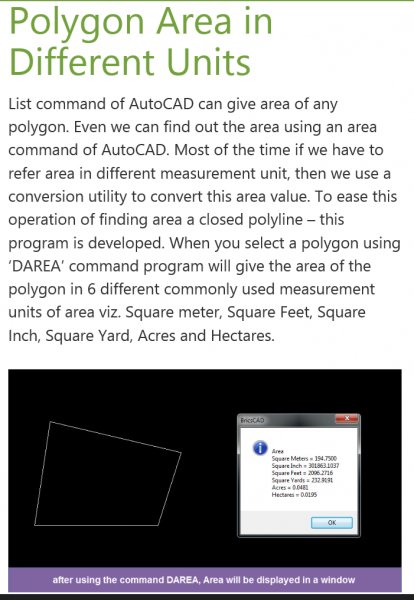

dgp123 Posted March 12, 2017 Author Share Posted March 12, 2017 I got this .fas file from ESURVERYING website. When select a polygon using DAREA command will give the area of polygon in 6 different measurement units viz. square feet, square meter, square inches, square yard, acres and hectares. THANKS IN ADVANCE...... DAREA.zip Quote Link to comment Share on other sites More sharing options...

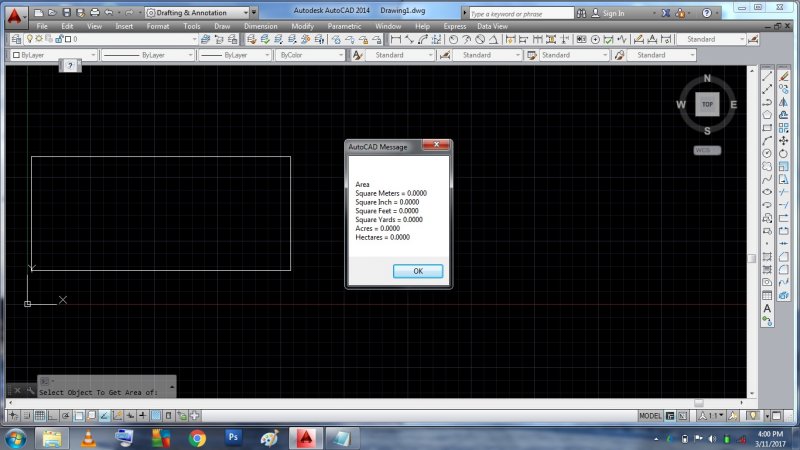

RobDraw Posted March 12, 2017 Share Posted March 12, 2017 I would contact the source of the code for trouble shooting. Or maybe it is working and the rectangle is too small. Quote Link to comment Share on other sites More sharing options...
dgp123 Posted March 12, 2017 Author Share Posted March 12, 2017 I try it for large rectangle but the answers is 0.0000 Quote Link to comment Share on other sites More sharing options...
RobDraw Posted March 12, 2017 Share Posted March 12, 2017 Have you verified the area by getting it in another fashion? Quote Link to comment Share on other sites More sharing options...
dgp123 Posted March 12, 2017 Author Share Posted March 12, 2017 Yes and I got the answer... Quote Link to comment Share on other sites More sharing options...
dgp123 Posted March 12, 2017 Author Share Posted March 12, 2017 Bro check it --- Forum -AutoCAD - AutoCAD 2D Drafting, Object Properties & Interface - DAREA.fas is not working. Need help Quote Link to comment Share on other sites More sharing options...
BIGAL Posted March 12, 2017 Share Posted March 12, 2017 (edited) You can not get into a FAS its compiled so if it does not work can not help. here is a simple start (vl-load-com) (defun c:plinearea ( / obj) (setq obj (vlax-ename->vla-object (car (entsel "\nPick Pline")))) (setq plarea (vla-get-area obj)) (alert (strcat "Area is sq feet " (rtos plarea 2 2) "\n\n" "Area is sq m" (rtos (* plarea 0.09290304) 2 2))) ) Edited March 16, 2017 by BIGAL vl-load-com added Quote Link to comment Share on other sites More sharing options...

pvsvprasad Posted March 14, 2017 Share Posted March 14, 2017 Please check the code. And Thanks for your response. hi all, Interesting post. i have tried your ".fas" code. i have created 5mx10m rectangle. and getting area as 50 sq.m. but square feet point of vile showing as 4.64 sft instead of 538.195sft. remaining units i am not tested. and another request is Place the area text with different units is best instead of dialog box results. we will wait for this version also. Best regards. Quote Link to comment Share on other sites More sharing options...
