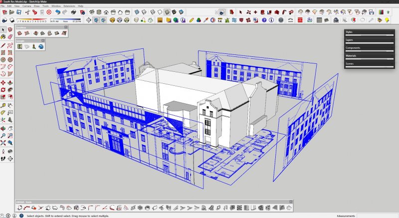

f700es Posted June 14, 2017 Posted June 14, 2017 its much more efficient to have your data attached to your reference so you don't need to look down to the paper while working, it also decreases room for confusion while working (3d perspective) I guess that it is up to the user. When I bring in a DWG file I strip it of EVERYTHING except just the base lines I need to model off of. I also NEVER use the CAD lines. I group the entire DWG as one group and always model fresh up the lines as a guide. See attached. To me this gives me a much cleaner model. Sean Quote
samifox Posted June 14, 2017 Author Posted June 14, 2017 I guess that it is up to the user. When I bring in a DWG file I strip it of EVERYTHING except just the base lines I need to model off of. I also NEVER use the CAD lines. I group the entire DWG as one group and always model fresh up the lines as a guide. See attached.To me this gives me a much cleaner model. Sean [ATTACH=CONFIG]61500[/ATTACH] my idea is reverse to yours, i want to use sketchup to produce elevations and cuts to Auocad Quote
