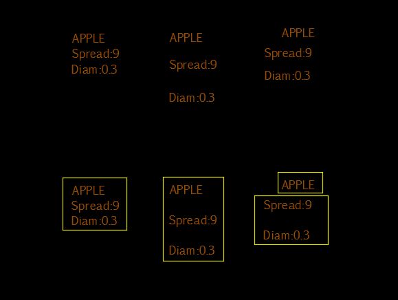

Rooster Posted July 13, 2017 Author Share Posted July 13, 2017 Ron - spoke a little too soon! I'm finding that your code does do what I want, but only if the starting bits of single line text are already in position. See the attached screenshot - above are three versions of single line text, underneath are the converted groups of mtext. The left one combines perfectly into one mtext object. The middle version keeps the wide line spacing, which I don't want - I'd like it to default to the left version. The right hand version combines 'Spread' & 'Diam' together, but 'Apple' is not joined to these because it's position is slightly different. (The yellow boxes are intended to indicate what your lisp has combined) Is it possible to build in any flexibility to this to cover these scenarios? Quote Link to comment Share on other sites More sharing options...

Rooster Posted July 13, 2017 Author Share Posted July 13, 2017 Thanks Ron. By entering a big enough value for xfuzz I can get the right of the three scenarios to now join into one piece of mtext, which it wasn't previously doing. However, I'm still not getting the line spacing that I want - on the middle and right bits of text where the three single line texts are spaced further apart, the conversion into mtext maintains this spacing. What I really want is for the mtext to look as the left hand version does, regardless of the vertical position/spacing of the single line text. Nearly there... Quote Link to comment Share on other sites More sharing options...

ronjonp Posted July 13, 2017 Share Posted July 13, 2017 Thanks Ron. By entering a big enough value for xfuzz I can get the right of the three scenarios to now join into one piece of mtext, which it wasn't previously doing. However, I'm still not getting the line spacing that I want - on the middle and right bits of text where the three single line texts are spaced further apart, the conversion into mtext maintains this spacing. What I really want is for the mtext to look as the left hand version does, regardless of the vertical position/spacing of the single line text. Nearly there... Code updated .. try again. Quote Link to comment Share on other sites More sharing options...
Rooster Posted July 13, 2017 Author Share Posted July 13, 2017 Code updated .. try again. Bingo! Thank you so much, Ron! Try https://www.theswamp.org/index.php?topic=40185.0;allJoe Burke's TextToMtext has a lot of useful features. Thanks, also Tombu - I'll check it out. You can never have too many lisps! Quote Link to comment Share on other sites More sharing options...
