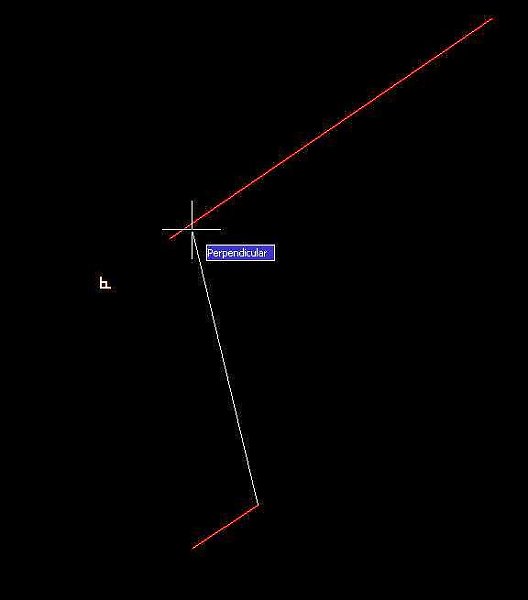

Is this what you are describing?

I took the distance command from the End of line 1 (short) and to the Perpendicular of Line 2, this gave me the offset distance. Is that the "apparent" or "extended" perperdicular point?:)

There is only one Perpendicular, but it will extend beyond the extent of the line...Oh dear, I think its time for a caffine break as I dont seem to be explaining this very well.:?
