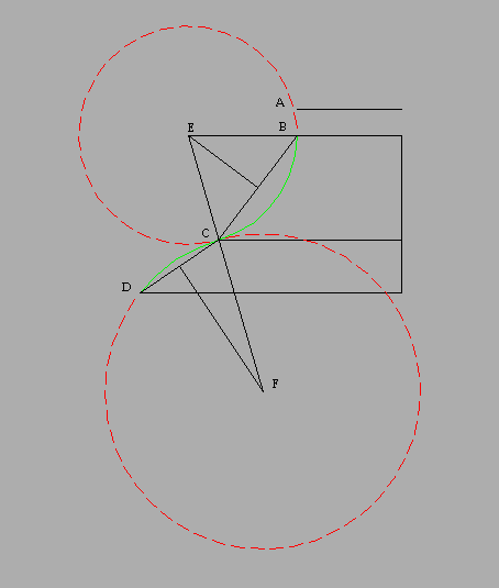

So back to the matter in hand which is to draw the green arcs. This is a special case where the uppermost point of the arc is tangentially vertical.
Draw the chord B-C. Draw the perpendicular bisector to meet the line B extended at E.
Draw the chord C-D. Draw the perpendicular bisector to meet the line E-C extended at F.
E and F are the centres of the circles, which now you can draw. Trim the circles, tidy up all temporary construction lines and there you have it.

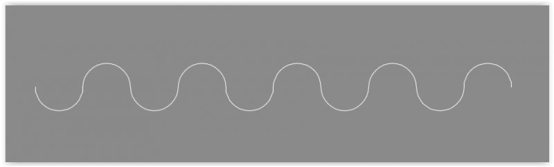

This is a pline using a repeating arc function within the pline command.

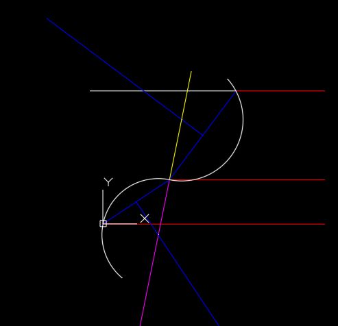

As noted, there are an infinite number of solutions to this problem but they all as Steven-g noted must have " two arc centres should be on a straight line that passes through the tangent point".
I created a parametric model (see attached file) that lets you dynamically review the solutions. Just drag the free end of the yellow or magenta lines and the arc radii and location will adjust automatically. It should be noted that in order to determine and reference the intersection point of the yellow line and the blue line (the perpendicular bisector) I cheated a bit. There is a small circle (0.01 dia) that is tangent to the two lines. This circle is used as the reference point for the center of the arc. There is a collinear constraint between the yellow and magenta lines
A Screencast of the movement is here: http://autode.sk/2DCVzXR
HowToDrawThis-1.dwg
