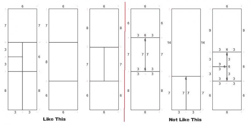

gadgetjay Posted May 2, 2018 Posted May 2, 2018 Hi all, I have to dimension hundreds of stands (drawn as a closed polylines) on a floor plan. I have found lisps that dimension all side of the 'stands' the problem is I don't need the internal dimensions so currently I am using 4 lisps.. select all left hand stands lisp adds left dims, bottom stands lisp adds bottom dim ETC. Can any one help stop me going grey by writing a code that only dimensions the outside and doesn't dimension the internal ones (where the polylines overlap). I think the attached pic describes it better. fingers crossed! Quote

hanhphuc Posted May 3, 2018 Posted May 3, 2018 Getting all points then remove internal points. Then need a clock sort routine so points are in a list. Then do dim pt1 pt2 etc. if floor plan is squared convex hull IMO is doable. my suggestion (if squared plan) boundingbox offset inner say 1% ssget crossing erase internal dimensions easier? Quote

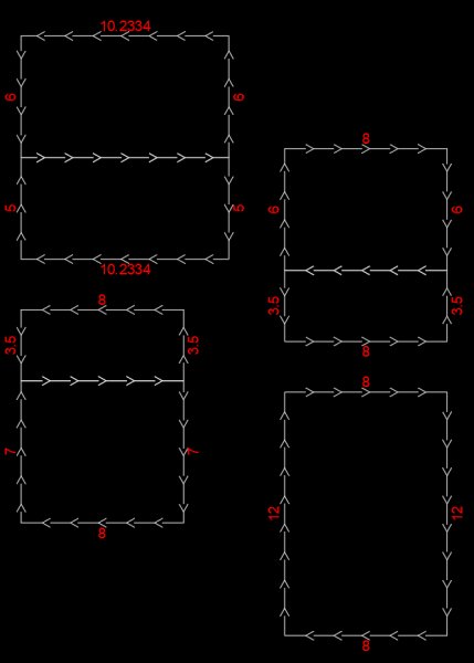

hanhphuc Posted May 6, 2018 Posted May 6, 2018 (edited) Here is a good start based off your example drawing. (defun c:foo (/ lm:makereadable _colinear a b d out p pp s th) ;; RJP 05.03.2018 ;; Labels exterior edges of 'stands' with edge length indeed a good start! IMO the idea / algorithm is worth more than coding. simple, short & faster than region boolean acUnion which need rounding tolerance is there a way to make the text offest 500 from the stand? - i tried justify text and 50% are inside 50% outside hi to be outside 100% the best solution is to involve or to learn coding ! Ronjonp has done 90% of your tasks my $0.02, In red to be tested (defun [b][color="blue"]outline_TX[/color][/b] (p1 p2 h [color="red"][b][u]cw[/u][/b][/color] / pl d ro) ;hanhphuc (setq pl (mapcar ''((x) (list (car x) (cadr x))) (list p1 p2))) (mapcar ''((a b) (set a (apply b pl))) '(ro d) '(angle distance)) (entmakex (mapcar 'cons '(0 100 100 1 10 40 50 8 71 72) (list "MTEXT" "AcDbEntity" "AcDbMText" [color="red"] (if (or [b][u]cw[/u][/b](< (* pi 0.5) ro (* pi 1.5)) ) (strcat (rtos d 2) "\\P ") (strcat "\\P " (rtos d 2)) )[/color] (apply 'mapcar (cons ''((a b) (/ (+ a b) 2.)) pl ) (if (zerop h) (/ d[color="red"] 10.[/color]) h ) ([color="red"]LM:[/color]MakeReadable ro) "OUT" 5 5 ) ) ) (princ) ) Edited May 6, 2018 by hanhphuc added new argument CW Quote

hanhphuc Posted May 6, 2018 Posted May 6, 2018 Hi hanhphuc, Trying to learn the coding but something like this is beyond my reach - it helps when there are notes in the code so you know what's happening. wasn't sure if you meant to place your code in Ronjonp's as a 'standalone' it errors malformed list? Good to hear you are learning you are right this is not simple. you can't simply add in the code, causing malformed list - missing parentheses or bracket ( ) or extra bracket ! to debug , command VLIDE or VLISP to open the editor a sub-function needs to supply arguments. i modified previous post#13 outline_TX function with additional argument cw. please re-copy quick & dirty test you try to draw 2 rectangles ccw & cw to test.. (defun c:test (/ s v ov l) (setq v '(angdir angbase) ov (mapcar 'getvar v) ) (mapcar 'setvar v (list 1 (/ pi 2.))) (while (setq s (ssget "_:S:E+." '((0 . "LWPOLYLINE") (-4 . "&=") (70 . 1)))) (setq l (mapcar 'cdr (vl-remove-if ''((x) (/= (car x) 10)) (entget (ssname s 0))))) (mapcar ''((a b) ([color="blue"][b]outline_TX[/b][/color] a b 0. [color="red"](LM:ListClockwise-p l)[/color])) l (append (cdr l) (list (car l))) ) ) (mapcar 'setvar v ov) (princ) ) ;; List Clockwise-p - Lee Mac ;; Returns T if the point list is clockwise oriented (defun LM:ListClockwise-p ( lst ) (minusp (apply '+ (mapcar (function (lambda ( a b ) (- (* (car b) (cadr a)) (* (car a) (cadr b))) ) ) lst (cons (last lst) lst) ) ) ) ) Quote

hanhphuc Posted May 7, 2018 Posted May 7, 2018 Thanks hanhphuc I appreciate the help but feel I drowning!I found if I add to Ronjonp's Code (setvar 'luprec 2) it places the text outside - is there a problem doing it this way? linear units precision 2,similar (rtos x 2 2) nothing to do with placement To suit your drawing, try to modify/add in the code post#13 (in red) (defun [color="blue"]OUTLINE_TX[/color] (p1 p2 h cw / pl d ro) (setq pl (mapcar '(lambda(x) (list (car x) (cadr x))) (list p1 p2))) (mapcar '(lambda(a b) (set a (apply b pl))) '(ro d) '(angle distance)) [color="red"](setq d (* d 0.001))[/color] (entmakex ..... ..... sorry about the 500 internal server error very painful to reply post iMO it's diffucult for you as newbie, nvm i try my best to assist, example in Ronjop's code just replace this part (setq pp (polar (car pt) (- (cadddr pt) (/ pi 2.)) th)) (entmakex (list '(0 . "TEXT") '(100 . "AcDbEntity") '(8 . "BoothOutlineLength") '(100 . "AcDbText") (cons 10 pp) (cons 40 th) '(62 . 1) (cons 1 (rtos (/ (last pt) 1000.) 2 0)) (cons 50 (lm:makereadable (cadddr pt))) '(72 . 1) (cons 11 pp) '(100 . "AcDbText") '(73 . 2) ) ) to this. [color="green"] ;; modified by hanhphuc [/color] ([color="blue"]OUTLINE_TX[/color] (cadr pt) (caddr pt) 500 (LM:ListClockwise-p (apply 'append (mapcar ''((x)(list (cadr x)(caddr x))) out )))) It's simple right? ( OUTLINE_TX FromStartPoint ToEndPoint Text_Height ClockWise_Predicate ) ; with 4 arguments. in blue is the function symbol & in deep purple is argument as you can see i also used Lee Mac's function LM:ListClockwise-p Quote
