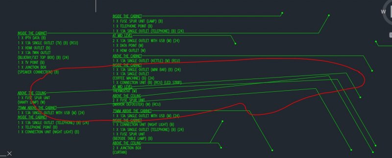

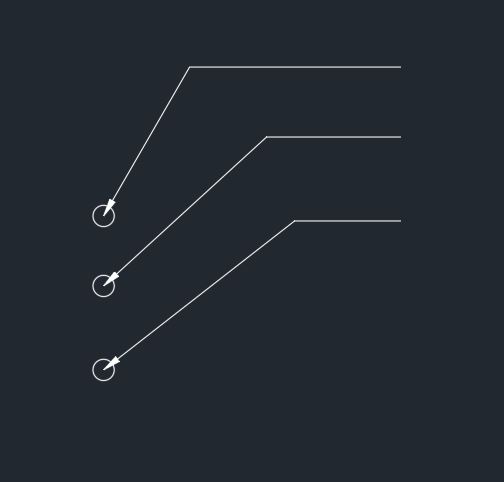

hello, any one can help me make multiple leader match same angle
mikewong0719

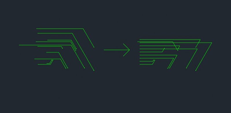

HELP, does any one have a method or lisp can make multiple leader arrange and match same angle ,because my job need to make a lot of multiple leader arrange ,anyone can suggest solve the problem ??
like from 1 to 2
but i try multileader algin, how can i change from leader to mleader, i found a lisp can change to mleader , but once time only can change 1 leader to multileader , how can i change all leader to mleader faster
because my job need to align over 300 leader and align , this too waste my time

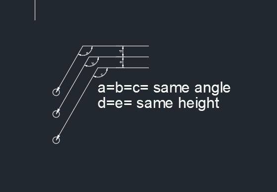

Give this a try:
(defun c:foo (/ _pts a d e el epts i mp n o p p2 s x y)
 ;; RJP 03.27.2018
 ;; Aligns 'old school' 3 pt leaders matching angle of leader and fixes offset distance of horizontal landings
 ;; ***The bottom most leader is the one matched***
 ;; Far from perfect, but better than doing it manually

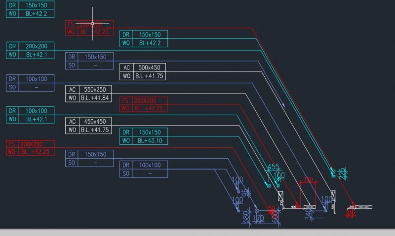

my drawing leader now can align, but leader have a block or text need to algin ,any method can make block align leader
Post a sample drawing.

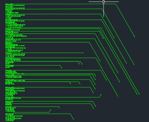

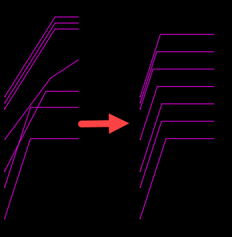

hello, any one can help me make multiple leader match same angle, because i have a lot of leader but leader angle not same , but my job need to arrange all leader make same angle, how can i do ??I only need same angle, no need same height
THX
in other post, i found this lisp, but i only need same angle, no need same height, but i don't know how to change this lisp, anyone can help me, pls

Try this, but it's untested... And I don't think it will be applicable for example picture you provided...
Please post the code in code tags next time :

(defun c:foo ( / mtchleader ss a i lea p1 p2 p3 mp )
 (vl-load-com)
 (while
   (or
     (not (setq mtchleader (car (entsel "\nPick matching leader - matching angle of this leader is reference angle for all other leaders..."))))
     (if mtchleader
       (/= (cdr (assoc 0 (entget mtchleader))) "LEADER")
   (prompt "\nMissed or picked wrong entity type...")
 (while
   (or
     (prompt "\nSelect leaders to match...")
     (not (setq ss (ssget "_:L" '((0 . "LEADER")))))
   (prompt "\nEmpty sel.set...")
 (setq a (angle (cdr (assoc 10 (entget mtchleader))) (cdr (assoc 10 (cdr (member (assoc 10 (entget mtchleader)) (entget mtchleader)))))))
 (if (ssmemb mtchleader ss)
   (ssdel mtchleader ss)
   (setq lea (ssname ss (setq i (1- i))))
   (setq p1 (cdr (assoc 10 (entget lea))))
   (setq p2 (cdr (assoc 10 (cdr (member (assoc 10 (entget lea)) (entget lea))))))
   (setq p3 (cdr (assoc 10 (reverse (entget lea)))))
   (setq mp (inters p1 (polar p1 a 1e-2) p2 p3 nil))
   (vla-put-coordinates (vlax-ename->vla-object lea) (apply 'append (list p1 mp p3)))
Regards, M.R.

this lisp doesn't work, anyone can help me, PLS
Replace this
with
(vlax-put (vlax-ename->vla-object lea) 'coordinates (apply 'append (list p1 mp p3)))
NOW THIS LISP IS WORK , BUT ONLY CAN MAKE ANGLE ,BUT LEADER SECOND LINE HAVE A PROBLEM , HOW CAN SOLVE?? pls
