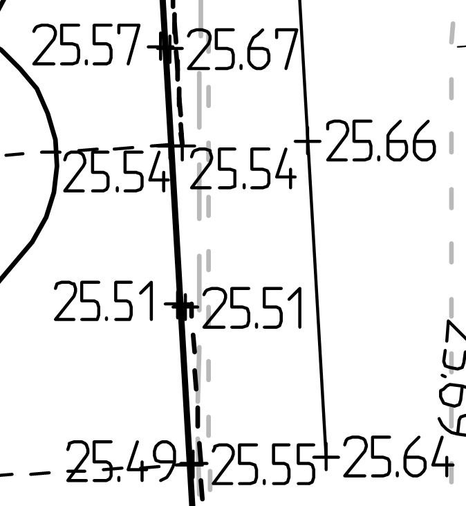

Fredricc Posted November 6, 2018 Posted November 6, 2018 Im searching for some lsp files or a solution for this problem of mine. Im kinda new here so i hope its the right spot to put out this question here. I was trying to find something about it but didn't so here i am!. What i want is to make visible attribute on ALL points in the dwg file. normally i open a dwg in auto cad with xyz coordinates but no visible points or anything, here i want to keep going with making this attributes like the picture. ddptype make me the "+" but the z coordinate gonna be in the same attribute with the "+" so it can be possible to put all those attributes in a separated layer for itself to light up if so. But still all the poly lines who have xyz will still have them on every point. Its like i want to make attributes as a copy of every point visible. i hope i didn't make it to complicated to read, but i did my best :) I have put it out to Lee Mac, who is the reason i find this great page, All ideas tips/trix are welcome :) Quote

Fredricc Posted November 7, 2018 Author Posted November 7, 2018 i want to make all points, at the same time, even if its a line i want it to be attribute on, i input a pdf to show how i want it, but ofc not in a pdf, but its a good view to maybe get it easyer to understand, Quote

Fredricc Posted November 8, 2018 Author Posted November 8, 2018 Its someting like this i want to do in the dwg file, i want not to export my points to pxy/csv before working with it, i want it in dwg when i make this happen Quote
eldon Posted November 8, 2018 Posted November 8, 2018 Your need would be fulfilled by setting up the import block correctly. The Z coordinate would be a visible attribute, whilst the X and Y coordinate would have invisible attributes. I would recommend against using an AutoCAD Point for the marker as the Point has zero lineweight and would always appear faint in print-outs. Use two lines to form a cross instead. Quote

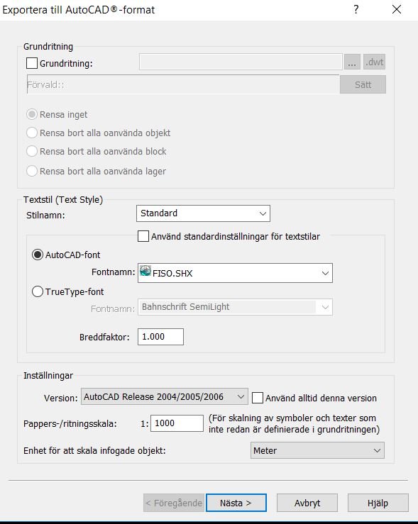

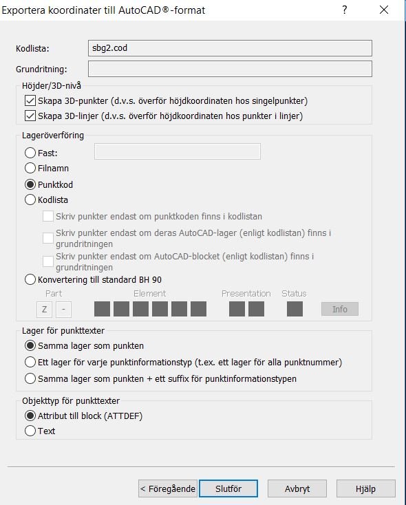

Fredricc Posted November 8, 2018 Author Posted November 8, 2018 Its another program i work my points in, the result i convert to dwg, most of the time the file format is called (.geo) Its sepcial for this program, so when im out meassuring i get it in a plm or what ever file format i want it, then i covert it to .geo and when its done i want to put it out to a dwg, becouse its what format that the most using. i cant see what info this will give you ? the thing is that i want to edit attributes in dwg format in zwcad, autocad you name it, and the reason is that i cant make it in the first program i use, I CAN light up z coordinate on all points, but they are linked to the point then and no (+) i want to put it to a separated layer the whole attribute, and the only way to make it happend as im seen it is to make it somehow in the cad program with a lisp or someting like that Quote
Fredricc Posted November 8, 2018 Author Posted November 8, 2018 Its a full map like a autocad drawing, but in a different format i working in before i put it to dwg, but im not able to make this change of attribute happening at this stage, my codes here, make my different layers for the different lines, it give me the only option to make someting like this in Cad. if i light up the z coordinate, and make command: ddptstyle or someting like that, i get a + on all points, but the z coordinate who has imported is connected to the line and the + is stand alone points, so its make it difficult to put them together to get them in a seperated layer with all attribute z. Quote
Fredricc Posted November 8, 2018 Author Posted November 8, 2018 thats the reason why i serching for something to make a attribute on all points in POLYGONS and stand alone points and put all this attributes to a separated layer, are you with me ? and dont complain about the language its great not.... Quote
