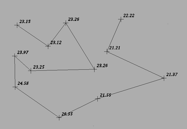

Fredricc Posted November 13, 2018 Author Posted November 13, 2018 (edited) pretty easy ? not for a beginner and cant find anything of anyone who made this on the google... the z coordinate of all break points have to be in the block text on every break point as the dwg shows if you fix it i ow you one! ^^ Edited November 13, 2018 by Fredricc Quote

Fredricc Posted November 13, 2018 Author Posted November 13, 2018 Thats a example of a line and some points i want to put attributes on, i made it on 30 second in zwcad just, its a perfect example, without attributes. Quote
eldon Posted November 13, 2018 Posted November 13, 2018 OK, that drawing does not contain any attributes that I can see. We may be going around in circles, but I thought that you wanted to use the Spatial Manager to input data, and then to get those attributes to look like you want it to. Obviously not! You seem to want to merely annotate the Z value of the 3D vertices of a polyline, so why use attributes? Quote
Fredricc Posted November 13, 2018 Author Posted November 13, 2018 Thats how i want it too look like, when it comes to insert data, use different programs, but that program does not support this attribute stuff to get the + and the text (z coordinate) in the same layer. thats what im serching for to make those attributes/blocks in dwg format IN zwcad Quote
Fredricc Posted November 13, 2018 Author Posted November 13, 2018 but when i got 500 lines and alot of attribute to pick, i want it to automatic make those attributes on every points on the drawing with some command or someting like that, becouse its no function in my cad who make it easyer to make this for me, Quote

BIGAL Posted November 15, 2018 Posted November 15, 2018 I have done something but it needs testing using a block would make the + part a bit easier as that would be the insertion point. Need some time to test, should have looked at Lee's point manager 1st though. (defun labelzs ( / x obj ss) (defun isline ( / stpt endpt) (setq stpt (vlax-curve-getstartpoint obj)) (setq endpt (vlax-curve-getstartpoint obj)) (command "text" stpt "" "" (strcat "+ "(rtos (caddr stpt) 2 3))) (command "text" endpt "" "" (strcat "+ " (rtos (caddr endpt) 2 3))) ) (defun is3dpline ( / y co-ords) (setq co-ords (vlax-safearray->list (vlax-variant-value (vlax-get-property obj "Coordinates" ) ) ) ) (if (= objname "AcDbLwpolyline") ( setq numb (/ (length co-ords) 2) inc 2) ( setq numb (/ (length co-ords) 3) inc 3) ) (setq y (length co-ords)) (repeat numb (if (= objname "AcDbLwpolyline") (command "text" pts "" "" (strcat "+ 0.0")) (progn (setq z(nth (setq y (- y 1)) co-ords)) (command "text" pts "" "" (strcat "+ "(rtos z 2 3))) ) ) (setq y (- y inc)) ) ) (setq ss (ssget )) (repeat (setq x (sslength ss)) (setq obj (vlax-ename->vla-object (ssname ss (setq x (- x 1))))) (setq objname (vla-get-objectname obj)) (if (= objname "AcDbLine")(isline)) (if (or (= objname "AcDbLwpolyline")(= objname "AcDb3dPolyline")) (is3dpline) ) ) ) (labelzs) Quote
