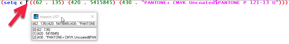

if I use this
(setq c ((62 . 135) (420 . 5415845) (430 . "PANTONE+ CMYK Uncoated$PANTONE P 121-13 U") ))
it returns ; error: bad argument type: consp 5415845
the 5415845 part in the error: bad argument type: consp 5415845 is from the True Colour text part of the code...
Lisp evaluates everything, so if you want/need to set a list without evaluating any part (like here, in your example) to a variable I would recommend quoting (once) the whole list
(setq c '((62 . 135) (420 . 5415845) (430 . "PANTONE+ CMYK Uncoated$PANTONE P 121-13 U") ))

Ooops ... guess I need to read all the replies closer @Jef! already touched on this. 😳

12 hours ago, ronjonp said:
You can't set CECOLOR to a list value .. furthermore you cannot use ITOA on a list? ITOA is used to convert an integer to a string.
Thanks @ronjonp - after changing colours from ACI to True Colour and Colour Book I didn't realise the same syntax wouldn't work
Here is what I think you're trying to accomplish:
Close. I noticed the linework changed colour, but it's the hatch I want to be coloured depending on the closed polyline m² area. Different m² areas will be different hatch colours. I'd also like to put each m² hatch on a seperate layer.
Search here did the different colour for areas geeee  maybe 4 years ago ? Trying to find it may be on a different computer. Make a list of pairs (area objectid) sort area then change colour.
